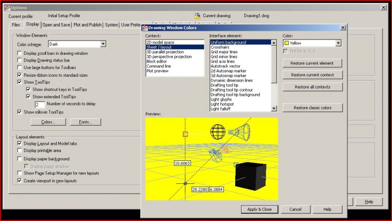

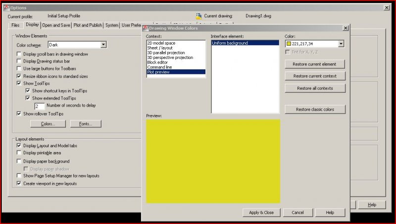

A few ways to go. You can open your options (right click in the command line, choose options) then select the DISPLAY tab and click on the COLORS button ..... take a look at the attachments. Choose whatever color you like. If your hatch, as described is causing you problems, you could just turn off the hatch layer while you work on any changes. It sounds like you have already sent the HATCHTOBACK, which should help too, if the layer is frozen or turned off, that shouldn't matter.

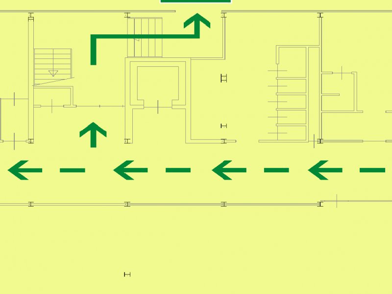

Right as rain, still prints white, although the print preview was, as expectecd decidedly yellowish. Buy some yellow paper?
Ya Dadgad,that is great!!!!! and how can i make it ( the wellow colour for bachground) only in the viewport , i mean to get the viewports with bach ground yellow and the other parts from the layout with whit for example? thanks for ur help
oh....i did not tried it but in preview i have yellow layout !
