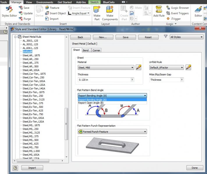

hassebassie Posted December 7, 2011 Posted December 7, 2011 Hello, I've got a problem with the bendnotes. I want to change the angle it displays, because our pressbrake uses an angle of 135 degrees instead of the 45 degrees in Inventor. For the standard angles it is no problem, but if you use somthing like 42 degrees a mistake is easely made. Quote
jdits7 Posted December 7, 2011 Posted December 7, 2011 Open you Sheet Metal.ipt template. Under the manage tab, click on Styles Editor, navigate to the sheet metal rule you want to change, about mid screen you will see Flat Pattern Bend Angle. You can change this to either Report Bending Angle or Report Open Angle. Only thing you will have to change this on all of your different sheet metal rules. Quote
hassebassie Posted December 8, 2011 Author Posted December 8, 2011 Thanks, I hoped it would be something easy as this. I just didn't know where to find it. Quote
