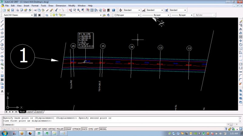

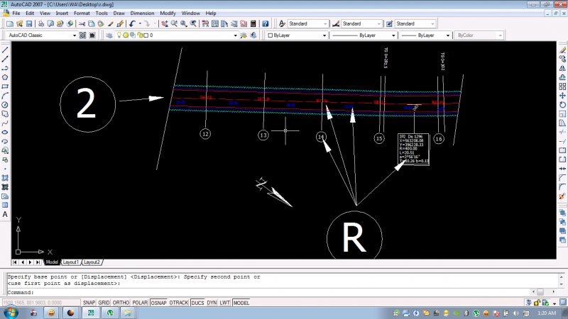

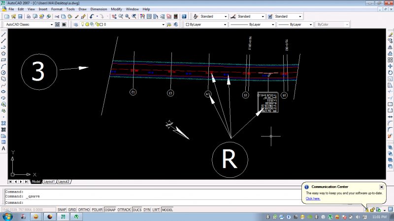

whiteangel10 Posted December 7, 2011 Author Posted December 7, 2011 I’ve just added some screenshots. I want to know if there is any command in Autocad so that, by selecting all the text (dimensions from R, #3), I could rotate all the elevations at the same time, and they still remain in the same place. I have a very long drowing, with many elevations, which looks like #1 and I want it to look like #2. After the `mirror` command, the drowing looks like #3. How can I rotate all the elevations with only one command, since I want the numbering increasing from left to right (like #2)? Quote

rkent Posted December 7, 2011 Posted December 7, 2011 I notice that the text in red (368.12) is actually 368 and .12 so the rotation with properties messes that up. Why is 368.12 two different pieces of text? This is typical for all the red text. Quote

ReMark Posted December 8, 2011 Posted December 8, 2011 Well it's too bad that the red text, which I assume represents an elevation (blue text represents a distance?) is made up of two parts because there is a "one button" or in this case a "one command" solution to the problem. Since you are running AutoCAD 2012 I assume you have loaded and are familiar with Express Tools. On the Ribbon click on the Express Tools tab. On the Text panel of that tab find the icon for Modify Text. Click on the down pointing arrow. Find and click on the Rotate Text icon. This will invoke the TORIENT command. TORIENT "Rotates text, mtext, and attribute definition objects so that they end up being as close as possible to horizontal or right-read (similar to the behavior of dimension text). Objects are rotated about their middle point in 180-degree increments." Too bad someone decided to break up the elevation text into two parts. How/why did that happen? Quote
eldon Posted December 8, 2011 Posted December 8, 2011 Too bad someone decided to break up the elevation text into two parts. How/why did that happen? Software writer taking an easy option I suppose somewhere there is a lisp already written which would join the text into one entity or Mtext? Quote
ReMark Posted December 8, 2011 Posted December 8, 2011 Makes no sense though. Why write an elevation in two parts? Yes, I've seen a couple of lisp routines that join text. Just found and tested a lisp routine called TextJoin and it worked on the elevation text in the OP's drawing. Quote
whiteangel10 Posted December 8, 2011 Author Posted December 8, 2011 yes, blue text represents a distance. ReMark, I'm interested if I can rotate them with Autocad. Can you rotate them with CIVIL3D2012? TORIENT is like MIRRTEXT-0 and MIRROR command. Quote
ReMark Posted December 8, 2011 Posted December 8, 2011 I have no experience with Civil3D. I'm not familiar with the method rkent has proposed. It may or may not be the best solution. I can offer but one other possible solution; it will, however, require two steps. Step 1. Use a lisp routine called TextJoin to join all text that consists of two parts. Step 2. Use the Express Tools > Text Rotate (TORIENT) command to then rotate all text. That is the best I can come up with. I am confident, however, that rkent can walk you through his approach if that is the way you choose to go. Quote
