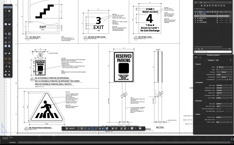

nager Posted December 6, 2011 Author Posted December 6, 2011 That is exactly the response I got from the architect...lol One thing that I noticed with what I see on my desktop is totally different from the desktop of the tutorials. I don't have all of the icons or options on my desktop like in the tutorials, attached is a screen shot of my desktop in the CAD program. Quote
emwhite Posted December 6, 2011 Posted December 6, 2011 That is exactly the response I got from the architect...lolOne thing that I noticed with what I see on my desktop is totally different from the desktop of the tutorials. I don't have all of the icons or options on my desktop like in the tutorials, attached is a screen shot of my desktop in the CAD program. You are on a Mac and a majority of AutoCAD users are on Windows. I know the Mac app is going to be different, screen wise, but you can still use the LINEWEIGHT command. Just type the word LINEWEIGHT in the Command bar at the bottom and press Enter or Return or Whatever Mac's call it. How about running Parallels with a Windows version of AutoCAD? Quote

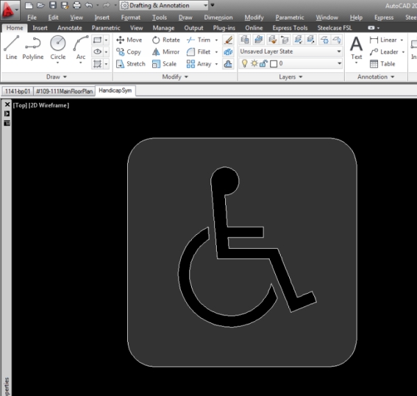

Tankman Posted December 7, 2011 Posted December 7, 2011 Attaching a test .dwg file of "handicap symbol". You might find some "ready made" road signs here http://www.cadforum.cz/catalog_en/?q=road+signs Quote
f700es Posted December 7, 2011 Posted December 7, 2011 OK I opened up your PDF in Illustrator and exported a DWG. In AutoCAD I noticed that the sign was a block. I exploded this. I then selected the sign (hatch) and right-clicked and selected Generated Boundry. This put a border on the sign. I used the DrawOrder command the send the sign behind the wheelchair graphics. I then used the trim command and selected the wheelchair graphics to cut out the hatch area from the sign. Quote
