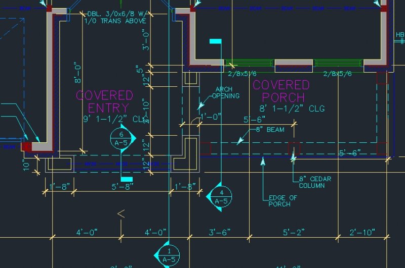

f700es Posted December 4, 2011 Posted December 4, 2011 Going to have to agree with Remark and JD you need to learn the correct way to draw in AutoCAD if you want it to work the correct way. All modern cad programs work this way. You always draw at 1:1 scale. Look at my ACad image, all items drawn 1:1 and the dims reflect this. Quote
