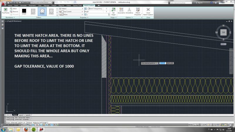

I have tried to search solution to this gap problem but with no success.
AutoCAD generates gaps to my drawing, sometimes there is NO gap and then it says there is when I'm selection new are to hatch (puts the red circle to old place where it didn't earlier say there is gap!). I have tried to use Gap Tolerance tool first with value of 10 but it didn't work. After that I changed it to 1000 and it worked but the hatch area wasn't good. I also tried to pull line over other and trim it, didn't work either. Used also join but it didn't work...
I have used object snap always when I drew the picture. I have zoomed as much I can and there is no gaps. I'm so confused! What to do?

Ddin't notice that my post came to here. I have been looking for this. Well, I got so hopeless so I joined all hatch areas to a one (it worked!). Here is one of the orginal pictures:

Have you tried isolating layers? The fewer objects on the screen the quicker and easier hatching becomes. In my experience AutoCAD sometimes tries to follow unexpected boundary lines where things touch or overlap.
