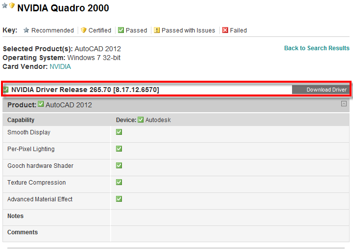

edwinprakoso Posted December 4, 2011 Share Posted December 4, 2011 Have you checked if your graphic card driver is the certified version? I've seen most updated version is not always the best version to work with. Check if you driver is the same version as mentioned in http://www.autodesk.com/graphics-hardware See attached image for your reference. Quote Link to comment Share on other sites More sharing options...
jaylo23 Posted December 5, 2011 Author Share Posted December 5, 2011 @ Remark - Not on subscription, its been acting like this for about 3 months now, was fine up until then @ edwinprakoso - Have checked and it says it was the certified, i have even tried rolling back to older drivers Quote Link to comment Share on other sites More sharing options...
