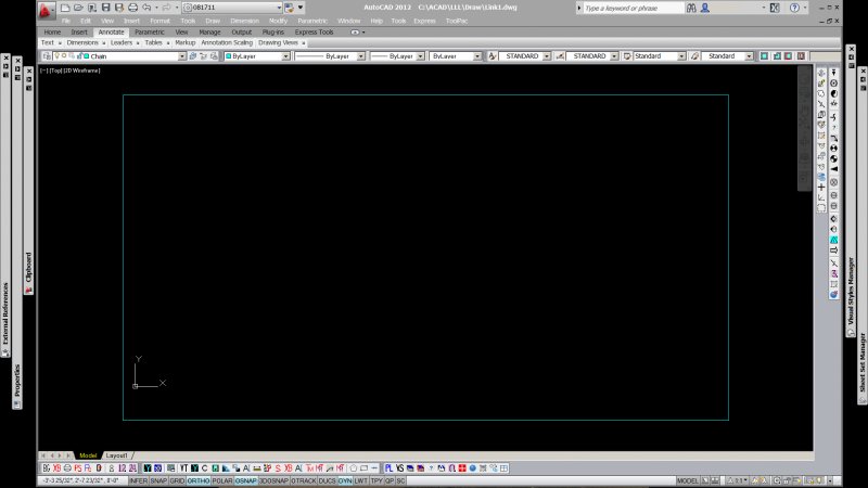

Patrick Hughes Posted December 5, 2011 Posted December 5, 2011 Alex, I have a similar approach where I like as much screen area as possible. Here's a couple of things I do. I auto hide windows task bar. I reduce the command line to 1 line and simply F2 when I need more info. I use a dual monitor with AutoCAD on my left (main) monitor. On the second monitor I have the aerial view always on which allows for super fast zooming. My graphics card allows for easy switching to multiple desktops so I have several set up and open "outside" programs on other sesktops. This eliminates the need to minimize/maximize windows. Quote
tzframpton Posted December 5, 2011 Posted December 5, 2011 rwhitt0724 - I agree with you, I don't use it as there are better ways to get around in 3D.Rkent, this comes as a surprise to be honest. I figure you would be one who utilizes and loves the Navigation Cube. Simply out of curiosity, what are some of your ways you find better than the Nav Cube? Quote
rkent Posted December 5, 2011 Posted December 5, 2011 I keep the ribbon on and minimized as I find more and more uses for it. I have several toolbars at the bottom and along the sides for customized macros, etc. I keep some toolbars and palettes on the second monitor along with the command line window. If I need a bigger screen I will use my custom clean screen work space as the built-in one eliminates too many tools for my use. With a work space I can have a few toolbars that are needed all the time. I have an ACADDOC.lsp file that loads my needed programs, (many through the Autoload function, this also loads a lisp file I call Qkeys.lsp and Settings.lsp. The Qkeys.lsp loads any alias commands I need and I don't modify the acad.pgp file as it seems redundant and a waste of time to maintain two files when one will do, and you can do a lot more in the lisp file compared to the PGP. The Settings file has lots of sysvars that I like to have set with each session. I have a folder C:\ACAD and I keep all my lisp files in this location. Under this folder I have C:\ACAD\LLL\XXXXX, with XXXXX being different named folders like TEXT, PLINES, MODIFY, DRAW, etc. holding lisp routines for those functions, making them easier to find when I am looking for one. I use Design Center quite a bit so I keep it on the second monitor and have my template defined for the home icon. I can quickly go there to pull layers, multileader styles, etc. into any drawing that doesn't have those already in it. Quote
tzframpton Posted December 5, 2011 Posted December 5, 2011 If I need a bigger screen I will use my custom clean screen work space as the built-in one eliminates too many tools for my use. With a work space I can have a few toolbars that are needed all the time.Never thought of this. Great tip!!! Quote
rkent Posted December 5, 2011 Posted December 5, 2011 Hi Tanner, I use a combination of quick keys for the various views, SE for SouthEast, TV for top view, RV for right, etc. I use 33 for 3dforbit (free orbit) which I like a lot for arranging a model off of the assigned views. Finally I have the view tool bar set up to let me quickly pick one of the assigned views, see attached. For me I find the Navvcube gets in the way, is slower to use and requires more accurate picks which takes my focus off of the design and onto the function of making the program work. To each their own. Quote
