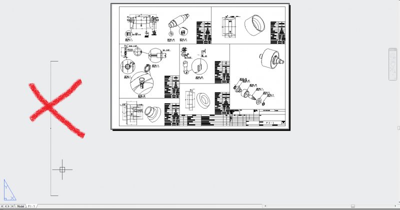

Alex Moiceanu Posted November 30, 2011 Author Posted November 30, 2011 1.I am sure that the dimension is in my layout.It does not appear in model space. 2.I've checked all the layers and all are unlocked.The dimension was created in layer 'Dimensions' which is also the current layer. 3.I created another dimension same way and it look as I expected.It's scalling when I zoom out or zoom in and I can erase it anytime. 4.More,I can't even select the 'problem dimension' and it seems to be stacked at my display whatever I do:zoom the window,pan the window, etc... 5.I created another layout with the Create Layout Wizard and all looks fine...The dimension no longer appear's but the problem still remains unsolved. I can't delete it from the first layout... Quote

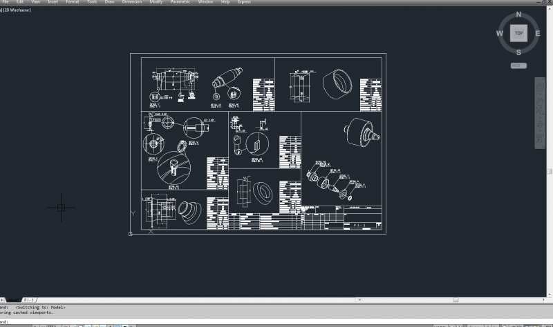

Alex Moiceanu Posted November 30, 2011 Author Posted November 30, 2011 I put two screenshots here... Quote
Alex Moiceanu Posted November 30, 2011 Author Posted November 30, 2011 As I said,the dimension marked whith red X it appears only in Layout F I - 1... Quote

Alex Moiceanu Posted November 30, 2011 Author Posted November 30, 2011 Quote Are you in paperspace or modelspace in Layout FI-1? In Layout F I -1 I was in paper space and then i switched to model space,as shown in the first picture attached(), who is actually the second screenshot I made. Quote

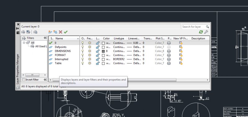

Alex Moiceanu Posted November 30, 2011 Author Posted November 30, 2011 This it's a screeshot of my layers... Quote
ReMark Posted November 30, 2011 Posted November 30, 2011 You said you cannot select the dimension therefore you have no sure way of knowing what layer it is on. For all you know it could be on layer Defpoints. As I expected. WHAT LAYER DID YOU PUT THE VIEWPORTS ON? Quote
