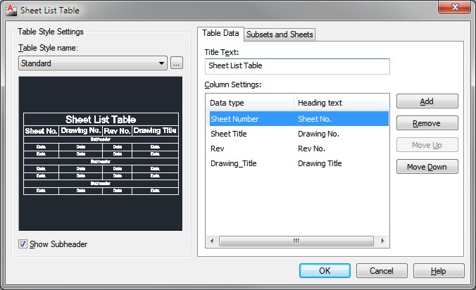

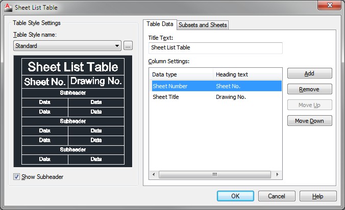

I have a very specific question regarding sheet sets, specifically the sheet list table that I am hoping someone 'advanced' in sheet sets can answer for me.
What I am having an issue with is for my sheet set templates to 'remember' which extra fielded attributes I want to have included automatically when I insert a sheet list table to my project.
I have the table format already by default selected, but it never remembers the extra columns I want to add. Example, when I run the command, it shows the sheet number and drawing number fielded attributes in the table, but I also want the revision number and the drawing title inserted as well. I have already previously set the rev and title up as a fielded attribute, it just seem redundant to have to always re-add the rev and title manually when there should be a place somewhere in my sheet set template to 'save' this so when I run the insert sheet list command, it will already know that I want these '4' columns. For some reason it just remembers the first 2.
I checked the table format, stuff like that but I have no clue where to adjust the template to ensure that I get the rev and title also inserted automatically.
Anyone have any idea where this might be? Any help would be greatly appreciated.......
The first screenshot shows what, by default is showing up when I run the 'insert sheet list table'. The second screenshot is what I want to have show up automatically. It seems redundant that I can not automatically save the sheet list format I want to use somewhere within my sheet list template and associated files. Hope this helps explain the question further. Thanks in advance.
