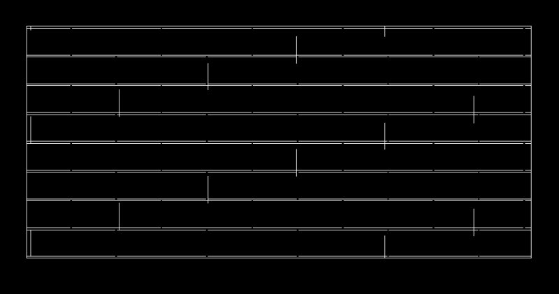

Hi I am trying to create a specific hatch for bricks and mortar. I have no problem creating the standard brick hatch but when I try to put mortar around the bricks that is when I get unstuck!
my horizontal lines and spaces appear to be okay but my vertical lines are all over the place, very confusing!!:?
I have attached my workings (have not yet got to the 4th line of code though!)if anyone can see anything that may help I would very much appreciate it!!!!

I think you had the repeat spacing and the dash space not correct. This seems to work.
*MYBRICK, Custom brick and mortar
0, 0,0, 110,70, 215,-5
0, 0,65, 110,70, 215,-5
90, 0,0, 70,110, 65,-75
90, 215,0, 70,110, 65,-75

Thanks for that, I think I sorted out - I seemed to have doubled up on some of my vertical lines??!! but it works now!!:D
