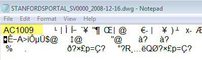

STANFORDSPORTAL_SV0000_2008-12-16.dwg
It's a newer version dwg. Open it in Notepad and look at the first line.
Use TruView to convert it.

saved as to 2004.
STANFORDSPORTAL_SV0000_2008-12-16r2004.dwg
