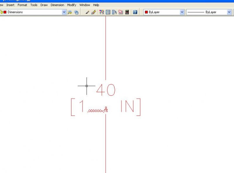

Here's the jist of why I needed it. My company has recently been bought out by a Mexican company and they produce glass fabrication drawings to us dimensioned in 1/32. I told the head honcho that none of our fabricators read in 32s and that they should just change their dimensioning to 1/16. They said that if they do that (since they work in Metric) some information could be lost from redrawing the Imperial piece back to Metric. I told them it's really very simple - Just draw the shape in Metric and dimension it in Imperial using the multiplier. Now, I've done this before drawing my shapes in inches and putting the Alternate units in Metric but not vice-versa. Since I've found the hidden .DWT files using the path that Stefan BMR gave me I can't seem to get my Imperial units to look right. See attached.
Any suggestions?

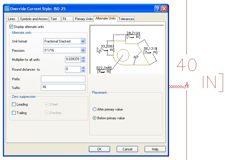

Here's what my dimstyles palette looks like:
It looks as though the fraction part of your alternative dimension has been shrunk and the screen resolution of the dimstyles palette cannot cope.
Probably easier to check the system variable DIMTFAC which is the scaling of the fractional part.
eldon,
I just changed it to "fractional" instead of "fractional stacked" and that fixed it. I tried your fix but it didn't do anything after I set it to "1", which is what it was already on.
