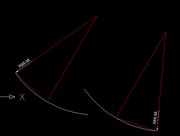

Hi guys
Tharwat, thanks for your input but I tested your code and it works fine but it was a little bit complicated.
The code that Alanjt programmed is almost exactly what I need only there is one little problem. Is it possible that the text always can be placed inside the arc? If you see at the picture, autocad put sometimes (I think depending how the arc is placed) the text (inside the red circle) on the wrong side of the arrowline.
Anyway, thx al lot for the input!
Grz

Hi guys
[ATTACH=CONFIG]31281[/ATTACH]
Grz
In your above picture, every dimension is inside it's corresponding arc.
yes, the place of the complete dimension (arrow, line and value) is inside its corresponding arc. But the place of the value (e.g. R80,88) is sometimes on the wrong side of the arrowline. The values should be both in the arc-area. It should be like the first picture above.
Could you give me an example when it doesn't operate how you like, rather than showing me what you want and telling me it doesn't work sometimes?
Ok, I'm gonna try to explain it :cry:
1. when I draw an arc and the center of the arc is above the start and endpoint of the arc than the place of dimtext is ok.
2. when I draw another one but the center is under the begin and end point than the place of both dimtext is on the wrong side of the line.
3. When the center of the arc is left or right of the begin and endpoint than one of dimtext is good and the other one is again on the wrong side of the line.
I hope this would be helpful.
