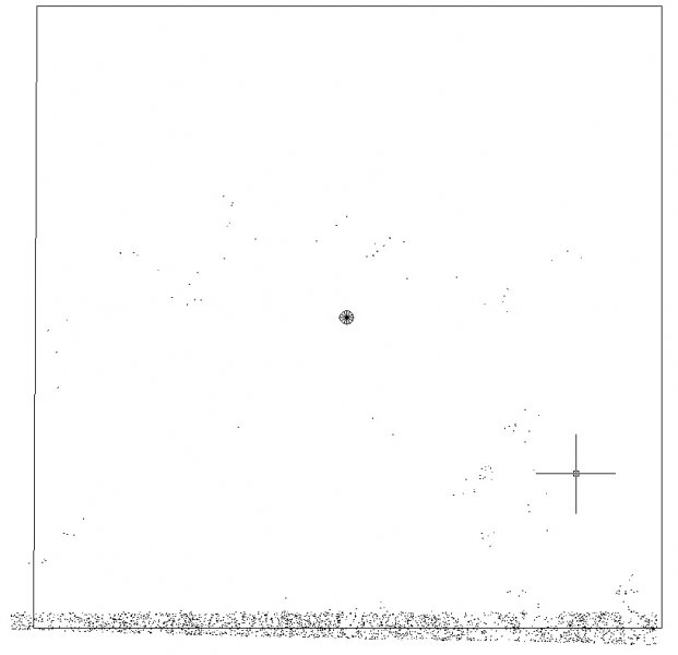

Henrikersna Posted November 21, 2011 Author Posted November 21, 2011 I am going to add a picture also just to give a better understanding of the problem. Polyline marks the tiff image location and basically the black dots are the labels that are being plotted. The thing is, that it actually copies exactly 2000 labels into text, which seems to be corresponding to the "rasterthreshold" command limit of 2000, is it coincidence? Quote
Henrikersna Posted November 21, 2011 Author Posted November 21, 2011 I finally found the solution to my problem (or to be more exact, somebody else found a solution for me in autodesk forum). Anyways, what i did was that i increased the maximum number of display manager feature labels that are displayed by configuring the Windows Registry to specify new value (in my case, instead of 2000 i upped it to 35 000, which was almost exactly what i needed) for the maximum number of labels displayed. After changing the registry, i just plotted it as usually, it just took alot more time. Heres know-how link for the future struggelers: http://usa.autodesk.com/adsk/servlet/ps/dl/item?siteID=123112&id=10408989&linkID=9240857 Or if the link goes down, just search http://usa.autodesk.com/ for "increasing maximum number of display manager feature labels displayed" Quote
