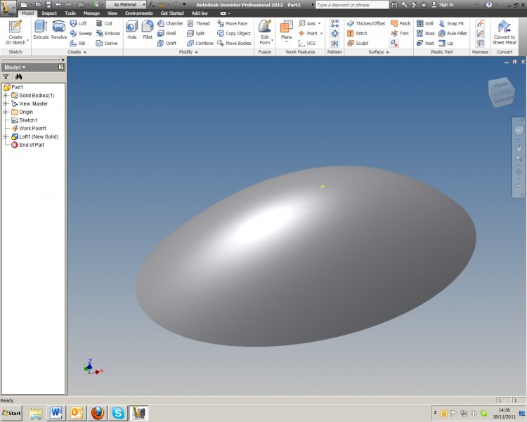

Hi Guys,
Anyone care to speculate why this should be so:
Picture 1: Sketch of an ellipse curve with a grounded point on it's centreline

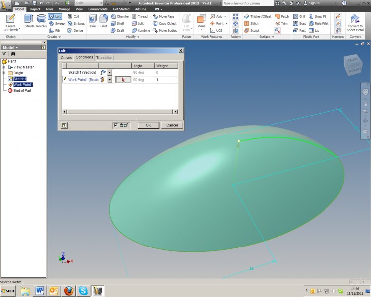

Picture 2: Lofted surfaced created with tangent edges (note guide curve generated by Inventor).

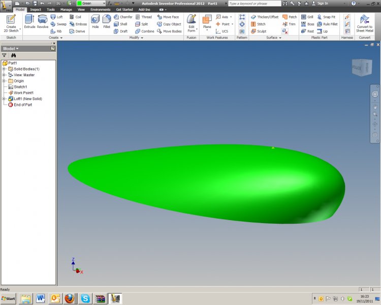

Picture 3: Finished loft - looks good, until .....

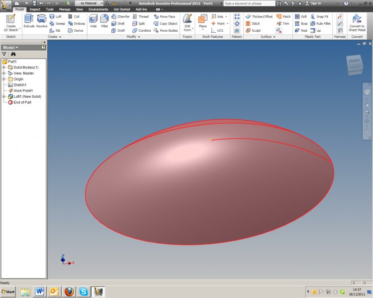

Picture 4: Cursor highlighting surface - note that the surface appears to have a split exactly where the "guide curve" was.

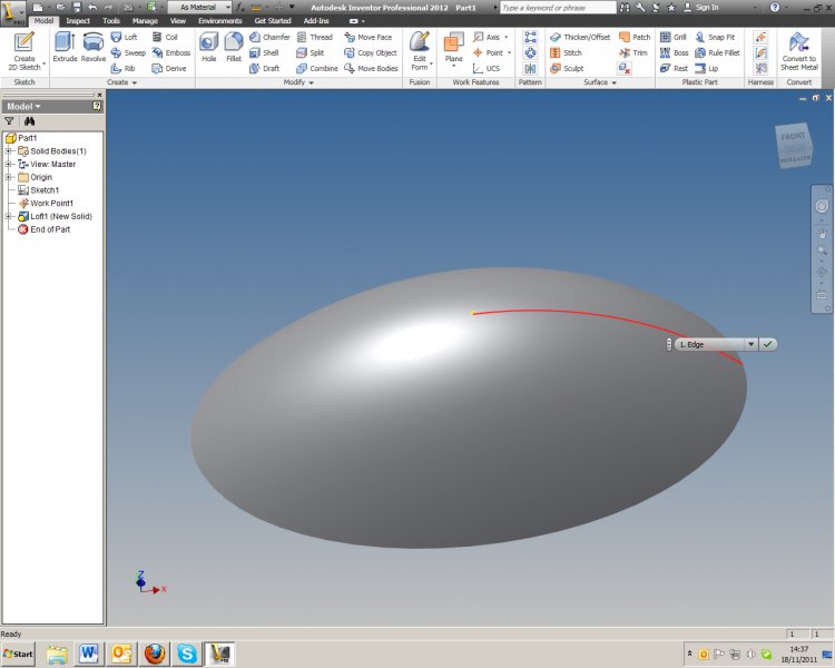

Picture 5: Yes, it is definitely a split surface as it is possible to select an edge????
This model was generated using Inventor 2012, but it is exactly the same using 2011. Why is this not a continuously smooth surface?

Ignore it. SolidWorks and Pro/E have the same seam.
If it really bothers you - there might be a way to create the geometry with a Boundary Patch.
(I might work up an example if I get some time later).

Turn off edge display. You are letting a artifact of the display fool you. The geometry is smooth.
Hi JD,
I already have edge display turned off.
Out of curiosity I imported an iges file of the model into SolidWorks 2012 and the surface split was not in evidence. However, when I re-imported it back into Inventor it came back. I couldn't decide whether it was actually present or not.
