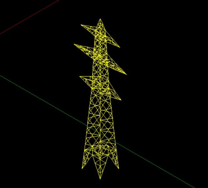

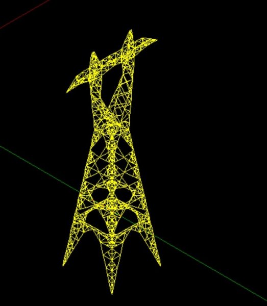

green77park Posted December 3, 2011 Author Share Posted December 3, 2011 Thanks friends I complete my 3d models Quote Link to comment Share on other sites More sharing options...
ReMark Posted December 3, 2011 Share Posted December 3, 2011 Very nice. Mind telling us the method you used? Quote Link to comment Share on other sites More sharing options...
green77park Posted December 3, 2011 Author Share Posted December 3, 2011 Thanks ReMark it is a hard way but the important I get the 3d model and I can complete my work thanks for your advise and encourage me friend Quote Link to comment Share on other sites More sharing options...
