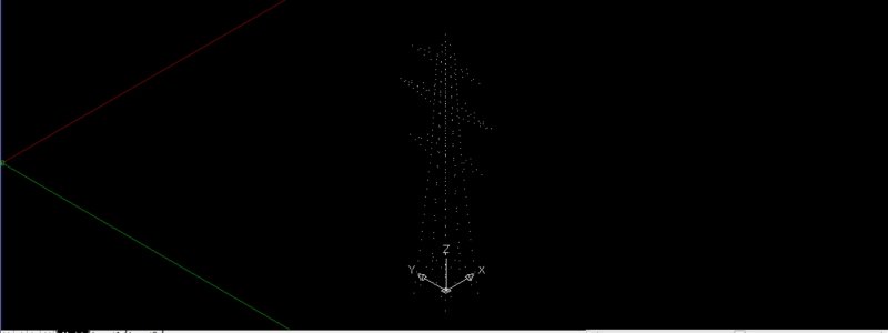

Any one can help me on my model I try to Draw Transmission Tower with Autocad and I have the coordinates of joints of this model on notepad I try to import it to autocad with many way it not succed any one have an Idea how can I do this and drawing the members (line between joints) easily with autcad 2007 I'll be thank for your help.....

Can you post an example showing the format of the file you're using for import? That may be your trouble. Also, AutoCAD, at least plain AutoCAD, will not import points like 3D Civil or Land versions will. There are however, other options like LISP routines which will import points from a file into your drawing file.
thank you bill for your replay the type is in XYZ in notepad and try with excel space delimit no way same result this is asample of my data

I think for AutoCAD to utilize it, it has to be a comma delimited file.
thanks freinds for help I try with the lisp ImportXYZ and get the 3d of points (joints) and I try to draw the line between the points it is not work and activate snap to catch the points but it is difficult how can I do this because I new with autocad 3d and the picture show the model in autocad with point
Wouldn't those points be considered "nodes"? If so wouldn't it be easier to select them if your enabled "nodes" as one of your OSnap settings?
thank you remark you are right it is work I forget to activate this option good luck but when I draw line is not appear in the window what is the problem the nodes in the zero layer I try to create new layer and see the result
Did you reorient your UCS? Did you also relocate the origin of your UCS?
Try using a 3DPolyline and see if that makes any difference.

One thing to watch out for - Layer 0 is your active layer - and turned off.
Anything you create snapping to those nodes will not be visible because your layer is not visible.
Also - this thing is mostly symmetrical.
I would put all but one leg on a hidden layer to clear up the screen.
For the arms I would only have one side visible while working on that geometry.
Looks like a pretty easy (but tedious in AutoCAD) problem.

Without making any changes to your drawing other than turning Layer "0" on, as previously mentioned by JDM, and adding "nodes" to my OSnap settings I was able to quickly draw a line from node to node without a problem. The only thing I can see that would be a problem for me is that I am not all that familiar with the construction of one of these towers (yes, I've seen them in the woods and along highways) and I might therefore draw a line between two nodes that would be incorrect as I'm guessing you sort of want to this to look like a 3D wireframe model. TA bit time consuming? Maybe. Impossible? No.
