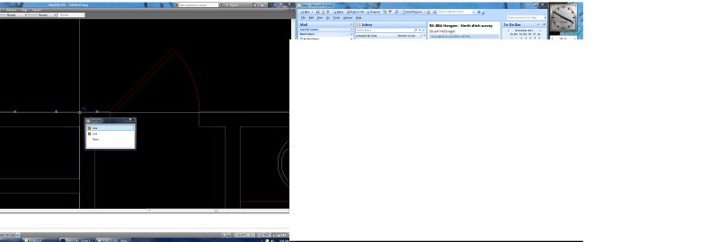

When i want to go and fillet, match properties, copy or do anything to a line that I have drawn, I have a selection box that pops up. it asks me what line I want to do it on. My co-worker is running the same program and he doesn't have this dialog box pop up. any suggestions on how to get rid of it? Its getting really frustrating and slowing me down a lot...
Can you post an image of that dialog box?
selection.jpg this is the print screen of it.
That's Selection Cycling. To turn it off set SELECTIONCYCLING = 0.

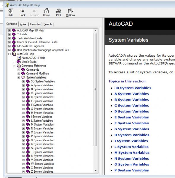

Do you know of a site or somewhere where I can find a list of all those different variables? myself and some coworkers are finding little things that we want/dont want and its all just changing the variables. So would there be somewhere with a list of them?
Thanks again,
The help files, under AutoCAD Help > Command References > System Variables. Scrren shot from Map3D but should be close to the same thing.
Also to get a list of them and the current values,
Command: setvar
Enter variable name or [?]
