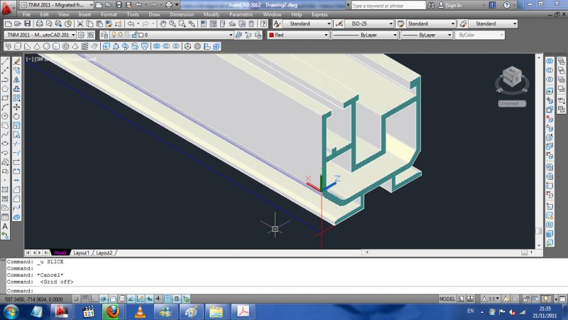

Hi,
I have just checked this out in Autocad and I don't know if its a new feature, but there is no need for UCS FACE. I use UCS, drag it to a corner and set the X and Y axis using mouse only. With Slice set to that origin point of the UCS, I enter for example for the second point 600
Need to Project Line
In the second and third jpegs, the projected blue line is the base line for the 45 deg construction line. I first use construction lines to get the corner, use copy edges, apply SLICE first point for that projected line endpoint to a second line
600

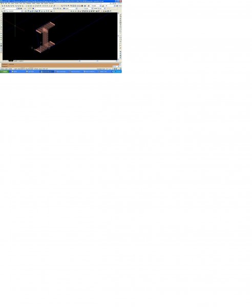

IBEAM.jpg Hi, I am new to this Forum , I tried to copy your solutions on how to slice an object using the ucs proper orientation vis a vis to the desired location. when i tried to do that to my 3d I beam using line with length of .35
Welcome to CADTutor. :)
My guess is that you extruded an unclosed POLYLINE, and may have generated a SURFACE
instead of a 3D SOLID.
If you select the OBJECT which you are trying to slice, what does the PROPERTIES box say that it is?
Once you DO HAVE A 3D SOLID with which to work,

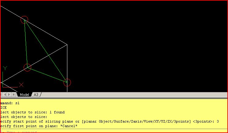

using the view as shown in your earlier post, change your visualstyle to 2Dwireframe,
then use the SLICE command, with the DEFINE BY 3 POINTS commandline option.
Then choose the corner vertices of your pyramid (which I circled in my screenshot), and read and follow the commandline prompts to complete the process.
I often use the 3POINT option, because I favor using an isometric view when modeling.
Very simple, once you choose a convenient isometric view, and have a viable 3DSolid to slice.

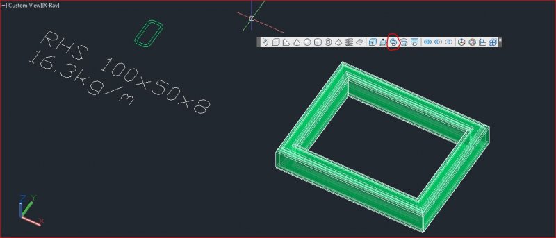

Using the SLICE command is pretty simple. I tend to create a large circle, centered on one of the points that defines the cutting plane, then Rotate3D by the appropriate angle, in such a case 45 would be appropriate. Then, after you have positioned the circle thusly you can call the SLICE command, and use the Planar Object commandline option. Read and follow the commandline prompts carefully.
But maybe what you are really trying to do is create a frame? If so, the following suggestion may help you.
If you have a drawing of the cross section, which is a Closed Polyline, you can very quickly do this with the SWEEP command, using the PATH option. Create your path, before you start the Sweep command. This technique will not create 4 separate pieces, but a single 3D Solid, which is generated along the rectangular path, as previously described.
