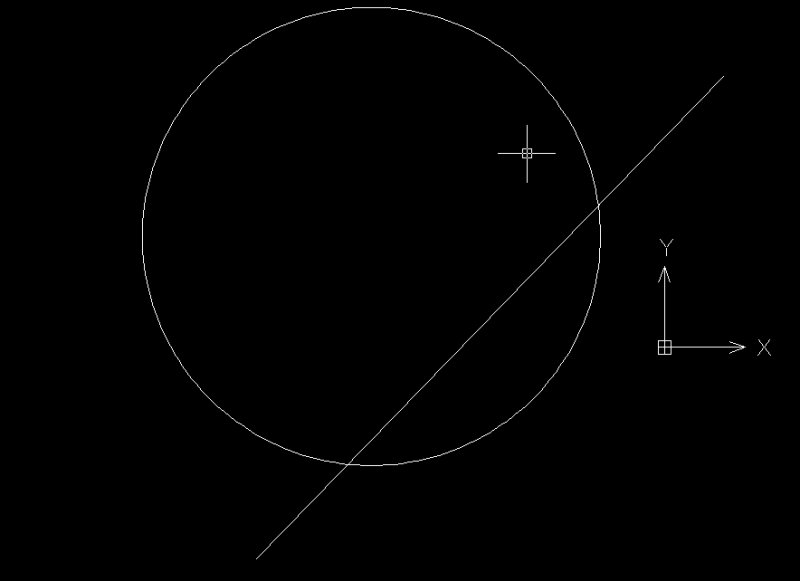

You right Lee, but I start playing with this:
try to find length of small portion of circle separated by line and selecting two points work OK. To get dimarc to work I need arc not a circle. That why I try to combine above two routines.
