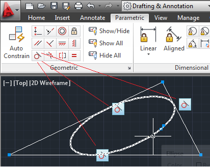

Are you familiar with geometry constraints?

@JD Mather: is it possible with geometric constraints? I'm not familiar with it...
Uhmmm, can't you see the picture? Drag any of the lines and the ellipse updates to remain tangent.
Ask your lecturer to show you how to use geometry constraints on the Parametric tab.

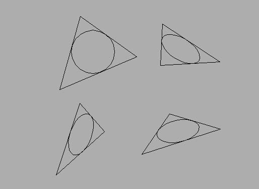

There are an infinite number of ellipses that can be tangent to any triangle. Your lecturer should demonstrate the desired solution for this particular problem.
Of course, if you just want to draw an ellipse inside a triangle, first draw a circle inside the triangle, and then rotate3d, about any 2point axis to suit :D
even though the circle will still be a circle, but it will look like an ellipse.
P.S. If you now flatten this rotated circle, it changes into an ellipse
