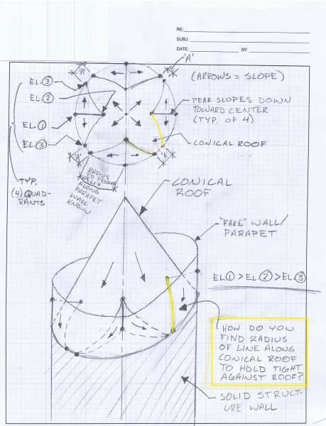

rwhitt0724 Posted November 11, 2011 Posted November 11, 2011 Hello everyone. I have started a project and have a somewhat unusual condition. I know this is not a detailing site, or an engineering site, but I figured there are some smart fellows on here that may be able to give a little input to this. I have a structure with a Conical Roof. We are putting a parapet around this roof. With the parapet, we are also going to create 4 individual structures that direct water/rain flow to scuppers that will be fabricated into the parapet. Below is a sketch of our condition. I was wondering if anyone knew how to get the shape of a line that follows the face of a cone. Obviously, this line is not projected to the center of the cone, so it is not just a straight line. I am imagining either a radial cut piece, or a complex/multiple radial cut piece. I don't really know how to put it into words exactly.... Take a look at the sketch and ask away. Also, if anyone knows a website where I may be able to do a little more research into something like this that would be great. Anyways... Here you go... Quote
SEANT Posted November 12, 2011 Posted November 12, 2011 I'm interpreting the sketch like so: ConeRoof.dwgFetching info... Quote

rwhitt0724 Posted November 14, 2011 Author Posted November 14, 2011 Fuccaro, I honestly have no idea what that thread means, lol.... I am not very familiar with LISP routines. SEANT, you are exactly correct in your interpretation. What I am trying to do, is fabricate those flat panels that you see going from that perimeter wall, down overlapping the cone roof. I am able to generate the peak of that piece and the helix along the perimeter wall but I am having trouble understanding/generating the radius/helix that will actually be resting along that cone roof. I am going to play around with it right now to see what I can come up, but yes SEANT, you are exactly correct in that interpretation. Quote
JD Mather Posted November 14, 2011 Posted November 14, 2011 rwhitt0724 said: What I am trying to do, is fabricate those flat panels that you see going from that perimeter wall, down overlapping the cone roof. ... I am having trouble understanding/generating the radius/helix that will actually be resting along that cone roof. . This entire assembly would be pretty easy using Autodesk Inventor sheet metal tools (will automatically give you the flat patterns). In AutoCAD to interpret those interestions you might 1.Change your active color 2. Run the xedges command (this will create curves at all of the edges - turn off the solid and then delete the edges you are not interested in). Quote
scj Posted November 15, 2011 Posted November 15, 2011 If I understood your problem correctly, so the bounding polylines of the unfolded surface area will give you the "wires" on the cone surface. Regards Jochen ConeRoof-scj.dwgFetching info... Quote
rwhitt0724 Posted November 15, 2011 Author Posted November 15, 2011 The only discrepancy I can see with both of the above DWG files, is that the sort of "roof dormer" we are making (for lack of a better description), the 2 pieces of sheet steel required, will not be rolled. We are trying to make a standard sort of gable style dormer; 2 sloped sides to form a peak. They will not be rolled in the sort of crescent shapes it appears these drawings show. Quote
