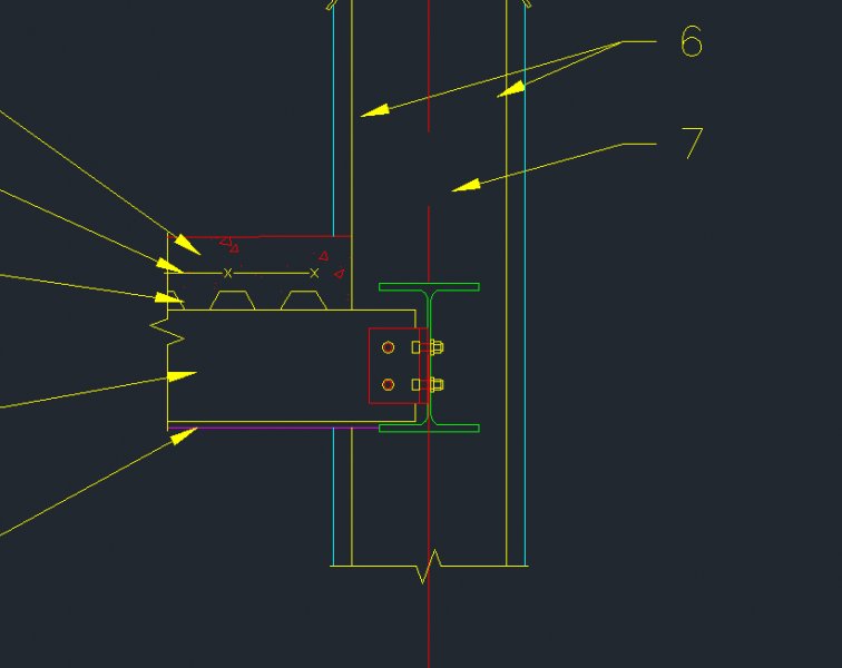

ReMark Posted April 16, 2013 Posted April 16, 2013 kamila said: ...and i am not sure but i think the metal sinidg is attached to the girders, right? so do i draw the columns that are behind? Thank you That's just one of many areas where the Penn-Foster project instructions come up short. They don't actually tell you how the metal siding is attached or to what. Since the siding is on the perimeter of the building it seems as though it would have to be attached to the perimeter beams but nowhere in the instructions does it tell the student how this is accomplished. Perhaps there is a piece of angle (ex. 3x3x1/4) welded to the top or bottom of the beams that extends far enough out so the back of the siding (I'm talking about the exterior siding) is flush with the face or edges of the columns. They just don't say. Quote

kamila Posted April 16, 2013 Posted April 16, 2013 and about that siding. can i keep it attached to the girders like i have or should i attached it to the beams? i am slowly learning construction:) Quote
ReMark Posted April 16, 2013 Posted April 16, 2013 The drawings are supposed to be set up to plot on a 11x17 paper size. That means your text can't be so small that it is unreadable. What text height are you using for your dimensions? What text height are you using for the callouts? There is metal siding running vertically (building walls) and metal decking (to support the concrete slab) running horizontally. Which are you talking about? Quote

kamila Posted April 18, 2013 Posted April 18, 2013 can i do the siding this way? what about concrete slab? where does it end? thank you Quote
ReMark Posted April 18, 2013 Posted April 18, 2013 I thought the channel rests on the top of the bottom flange. Yours is slightly off the flange. "Can I do siding this way?" I'm not sure what you mean. The siding is vertical. In a section it would be represented by a straight line. The concrete slab would normally end at the outside edge of flange. During the construction phase a plate would be welded to the flange to act as a barrier around the perimeter of the floor. Once again, Penn-Foster fails to give the student enough information thus leading them to guess what is expected of them. Contact your "instructor" to get clarification. Quote
