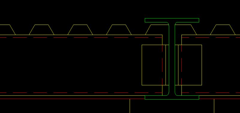

ReMark Posted August 27, 2012 Posted August 27, 2012 (edited) I believe the decking rests on the channels. The bottom of each channel rests on the top face of the bottom flange. Something like this: Edited August 27, 2012 by ReMark Quote

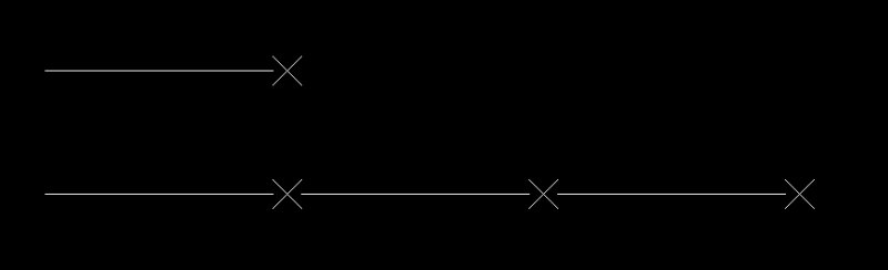

gowinmodi Posted August 28, 2012 Posted August 28, 2012 Good Afternoon ReMark, I like to know in plate-3 (page 15) how do i draw welded wire fabric are #12 gage 6" on center . on book they saw line and x symbol for WWF but i dont know how to make X symbol in Auotcad . Thank you Quote
ReMark Posted August 28, 2012 Posted August 28, 2012 I would create a block. You have a couple of options. The first would be a block just of the "X". The second would be a line segment with an "X" only at one end ( -------- X ). Get the idea? Quote
ReMark Posted August 28, 2012 Posted August 28, 2012 My welded wire fabric block is at the top. One line segment with a "X" at the right end. Below that is a group of three created with the ARRAY command. Pretty simple to make and to use. While you might be tempted to draw a single long line then place a block of an "X" along it at intervals, using the MEASURE or DIVIDE command, don't do it. Why? That would look more like a chain link fence. The welded wire fabric should have a "gap" between ends of line segments where the "X" would appear. I probably should have left a little more room on either side of my "X" but you get the idea right? Quote

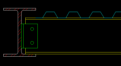

ReMark Posted September 10, 2012 Posted September 10, 2012 warpath: Regarding Plate 2. 1. The student is asked to dimension the overall height and length of the structure. You show only the height. 2. You have dimensioned the rebar in the footing. That is not called for in this plate. 3. You have failed to show the decking on the upper levels that is needed to hold the concrete slab. 4. The steel cladding on the side of the structure is dimensionally wrong. 5. Where are the baseplates for each column? 6. Don't you need a "J" bolt for each column in this view? 7. Linetypes for some layers are wrong. 8. Your missing some callouts (ex. - 8" layer compacted sand). 9. Arrowheads too small. 10. The channels are not supposed to be centered on the beams. The bottom of the channel is supposed to be flush with the top side of the bottom flange of the beam. 11. Dimensions shouldn't have extension lines running through them. Perhaps your dimension text height is a bit too large? 12. You're missing the clips that hold the beams to the columns. 13. You're missing the steel in the piers. These are the obvious things I have picked up on. I'm sure I missed a couple. Quote

ReMark Posted September 11, 2012 Posted September 11, 2012 Concrete pier footing detail example. http://www.prlog.org/10539485-concrete-pier-footing-details-reinforced-concrete-detailing-service.html An example of a beam and channel with decking. Quote
