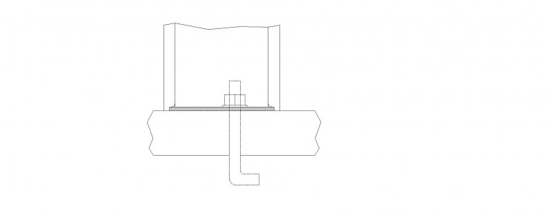

ReMark Posted November 17, 2011 Share Posted November 17, 2011 There is a CAD drawing of a roof drain detail here. http://www.cadcorner.ca/caddetails/archdetails.php I am familiar with Plate 7 however your reference to Plate E1 is incorrect. That would be Detail E1. It would be an enlarged detail showing the "J" bolt that anchors the column. The bolt is 1 1/2" in diameter and 18" long. A "J" bolt has a small hook at the end thus the reason for its name. The bolt projects 3 1/2" above the baseplate. Normally there would be both a washer and a nut securing the bolt at the baseplate. See "rough" sketch below. . Quote Link to comment Share on other sites More sharing options...

ReMark Posted August 21, 2012 Share Posted August 21, 2012 (edited) It depends on what you mean by "...share with me." Please elaborate. What are you having trouble understanding? You are being asked to draw a building using structural shapes. One of those shapes, a W12x152, will be similar to that shown in post #13 of this thread with the only difference being the actual size (height, width, web and flange thicknesses). Sometimes this shape is referred to as an "I" beam. The vertical leg is called the "web" while the two horizontal legs are called "flanges". At the beginning of the project you will lay out a grid and locate 20 of these "I" beams, or columns, in plan view. Have you at least accomplished this much? Edited August 21, 2012 by ReMark Quote Link to comment Share on other sites More sharing options...
ReMark Posted August 22, 2012 Share Posted August 22, 2012 Continuing where I left off yesterday. Each column will have a baseplate 14x14x1/2 thick. Each baseplate will be anchored with two "J" bolts. They are called "J" bolts because they mimic the shape of the letter. When you draw the baseplate and column in plan view you should include the holes for the "J" bolts which would normally be 1/8" larger than the bolt diameter. The baseplates are anchored into a concrete pier and each pier is supported by a 32" square footing that is 16" thick. Your instructions will tell you what is to be shown in Plate 1 (plan view). In Plate 2 you'll be drawing an elevation view of the south side of the building. Pay particular attention to the way the columns are situated as it will determine what you draw and how you draw it in the elevation. If I recall correctly you will be looking at the face of flange so the column web, which is hidden from view, would be drawn with a dashed or hidden linetype. Quote Link to comment Share on other sites More sharing options...
