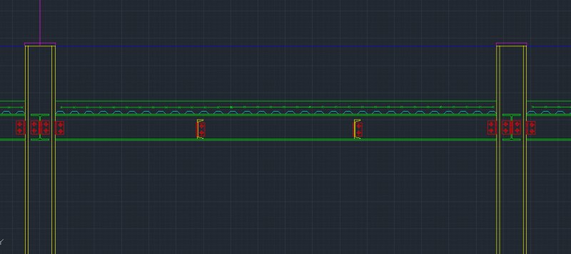

Capture roof wire mesh 1.jpg ok so i added the wire mesh and made the roof so that it looks like itis going away from me, as if it were heading to the drain at he far side of the building. this is what i understand it too look like. do you think that the roof looks good?
I think you neglected to read my previous post.
llike you said, there will only be one drain. i put one at the far end. between 2 and 3. you cant see it because it is behind everything.

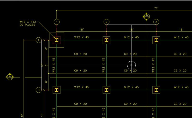

ok so ive read into plate 4. now from my understanding of this is that im just drawing plate 1 again, except i will be circling one of the channel beams connections to the girder. and then the last thing would be to put dimensions and the elevations. is it really that simple?
The roof drain is supposed to be shown in Section A (Plate 3). Section A is cut through the long axis of the building which would be the 72 foot length. P-F tells us on page 14 of the instructions that the drain is located between columns 2 and 3 and rows A & B. Since they don't define what "between" actually means let's assume it is equidistant between column centerlines. Thus, in plan view, this is where the roof drain would be located.
Personally I think it is pretty stupid to locate a roof drain in one corner of the building and in this case even more so since on page 2 of the instructions the student is told that "the sides of the building are 25" to 30" higher than the roof's surface and the roof is sloped towards the building's center."
Based on that last line, in my opinion, the roof drain should have been located between rows B and C and either just east or west of column centerline 3 (to avoid the W12x45 below). That would make more sense.
BTW...there is no indication in the instructions whatsoever as to what happens once the roof drain has penetrated the roof slab. There is no pipe passing vertically through the floors below to direct rainwater to a storm drain or to the ground. Another example of how poorly thought out these projects are. Yes, I know, purists will counter that P-F is not teaching civil, structural, electrical, etc. design/drafting; they're teaching AutoCAD. But shouldn't the projects at least make sense from a real world practical point of view? Little things like this just cause unnecessary confusion. OK...I think I need another cup of coffee before I move on. Be right back.

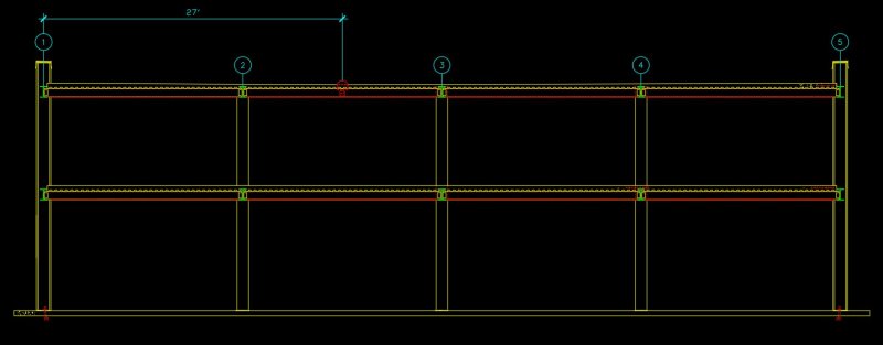

OK...this is how most students show the roof drain.
The drain falls midway between column 2 and 3 centerlines passes through the roof and terminates. I guess P-F is using the roof drain as sort of a poor man's shower.:lol:
Note that in this student's drawing the outside walls terminate 24" above the roof surface not the 25" to 30" as per the project instructions (page 2). Also the slab thickness at either end is 6" while at the centerline of the drain it is 4 9/32". Not sure how he arrived at that.
So the question becomes how do we address the slope of the roof? I think the instructions are ambiguous thus at this point I'd suggest contacting your instructor to get some clarification. Let us know what he/she says. I'd be really interested. Or you can give me his email address and I'll ask.

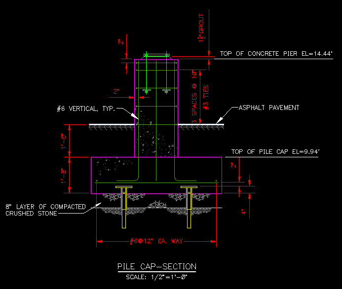

Re: rebar. The instructions on page 19 call for the student to show the rebar in details D1 and F. You'll call out the size and spacing of the rebar (ex. - #4 @ 12" O.C. Both Ways). Rebar is typically used in footings, piers and slabs. You'll have to show rebar and call it out on Plates 6 and 7 as well.

On 9/11/2012 at 5:59 AM, ReMark said:
An example of a pier, footing and pile cap. Notice the hatching? Just enough to get the point across without being obtrusive.
