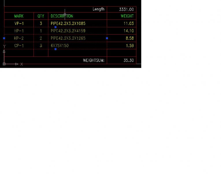

Lee Mac Posted November 9, 2011 Share Posted November 9, 2011 Yes. But it doesn't highlight the cells. What messages do you receive then? If any? Does the program error? Here is the result on my system: Quote Link to comment Share on other sites More sharing options...
muthu123 Posted November 9, 2011 Author Share Posted November 9, 2011 There is no error. But it is not high lighting as your image and simply executing. Quote Link to comment Share on other sites More sharing options...

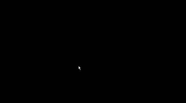

muthu123 Posted November 9, 2011 Author Share Posted November 9, 2011 This is the output from my system. Quote Link to comment Share on other sites More sharing options...

muthu123 Posted November 10, 2011 Author Share Posted November 10, 2011 Dear Mr.Fixo, Thank you for your reply. But the result is same and it is not highlighting the cells. Now i have doubt that in my PC settings. Quote Link to comment Share on other sites More sharing options...
