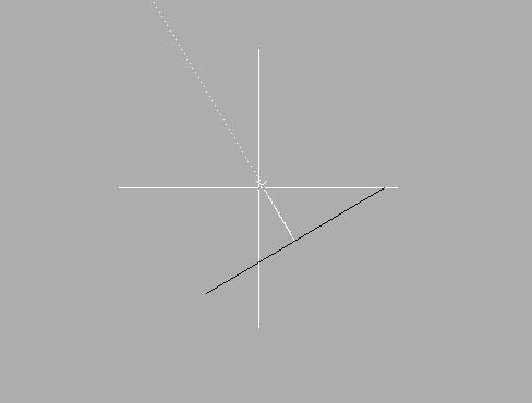

MSasu Posted November 8, 2011 Share Posted November 8, 2011 (edited) I will draw a line from an arbitrary point perpendicular (OSNAP mode Perpendicular) to that line and move it later to the middle (OSNAP mode Middle) of the line. Regards, Mircea Edited November 8, 2011 by MSasu Added an image Quote Link to comment Share on other sites More sharing options...
