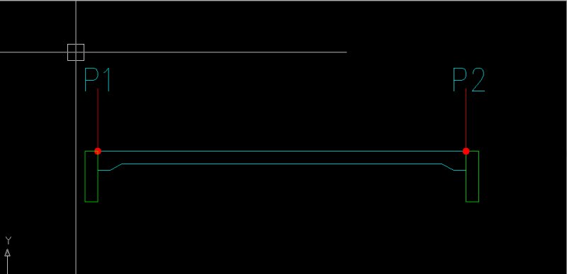

(defun c:test ()
(setq p1 (getpoint "\nPick point L: ")
p2 (getpoint "\nPick point R: ")
p3 (polar p2 (dtr 270.0) (+ (/ 0.10 2)0.10))
p4 (polar p3 (dtr 180.0)0.10)
p5 (polar p4 (dtr 150.0)0.10)
sum (- (distance p1 p2 )0.373)
p6 (polar p5 (dtr 180.0) sum)
p7 (polar p6 (dtr 210.0)0.10)
p8 (polar p7 (dtr 180.0)0.10)
Layer "A-BEAM"
);endq
(command "_layer" "m" Layer "")
(command "pline" p1 p2 p3 p4 p5 p6 p7 p8 p1 "")

First, you will need to provide more information regarding what you want to achieve - after disabling the OSMODE the routine draw something, just cannot know if is wrong or not:
(setvar "OSMODE" 0)
Second, please edit your post to follow the rules for code posting.
Regards,
Mircea
pick p1 p2 draw section concrete slab on ground

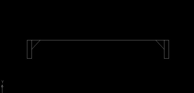

Please see below my corections in red:
(defun c:test ( / [color=red]MyOldOsmode MyOldOrtho[/color] )
[color=red] ;retain current setting to be able to restore later
(setq MyOldOsmode (getvar "OSMODE")
      MyOldOrtho (getvar "ORTHOMODE"))
;disable auto-Osnap and activate Ortho mode
(setvar "OSMODE" 0) (setvar "ORTHOMODE" 1)
[/color]
      p2 (getpoint p1 "\nPick point R: ")
      Layer "A-BEAM"
);endq
[color=red] ;restore previous environment
(setvar "OSMODE" MyOldOsmode) (setvar "ORTHOMODE" MyOldOrtho)
[/color] (princ)

Mircea , you have localized your added variables only , so what about the rest variables and the subfunction DTR ?
There are many improvements that can be done to that piece of code - I have only fixed it to work as OP expected. I don't intent to re-write it.
