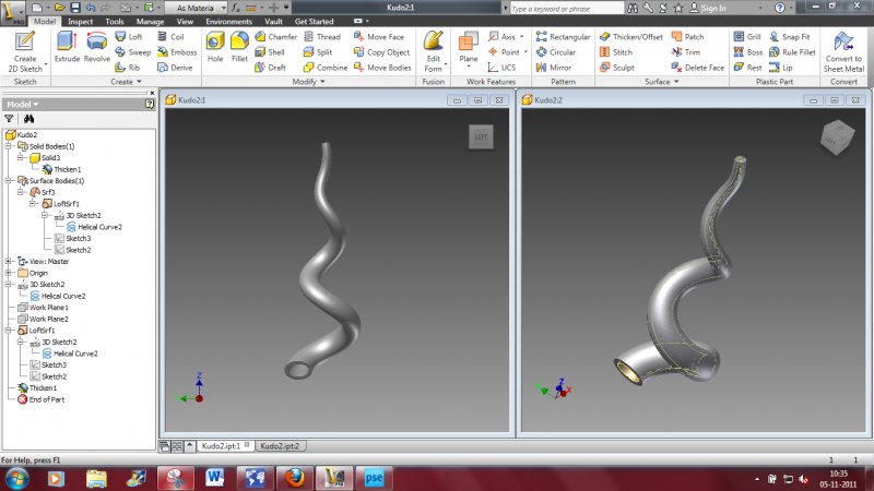

reganj Posted November 1, 2011 Posted November 1, 2011 Hello, I am new to Autodesk Inventor and unsure if the following is possible. I would like to design a pipe in the shape of a kudu horn or shofar (see attached). The cross section of this pipe is approximately elliptical/egg shaped and its inner diameter decreases along the longitudinal axis. The pipe is then wrapped around another imaginary cone. Any assistance would be greatly appreciated. Kindly, Jordan Quote

Incadnito Posted November 5, 2011 Posted November 5, 2011 Something like this u mean? Just a quick sketch, can be done more in more sofisticated manner Quote
reganj Posted November 9, 2011 Author Posted November 9, 2011 Yes! That is awesome. Thanks so much. Quote
reganj Posted November 9, 2011 Author Posted November 9, 2011 Would you mind sending me that file or is that to much to ask:unsure:? Quote

reganj Posted November 9, 2011 Author Posted November 9, 2011 A contributor from the Autodesk forum sent the following attachment to me. I have been playing with it and trying to mimic what he/she has done. I am on a 30 day trial and just learning this program for the first time. kudo horn test.ipt Kindly, Jordan Quote
JD Mather Posted November 10, 2011 Posted November 10, 2011 I would not use a 3D sketch for the helix as it is easier to create and edit a Coil Surface to do the same thing. Students can get a free 3-yr license for Inventor from http://www.autodesk.com/edcommunity Quote
JD Mather Posted November 11, 2011 Posted November 11, 2011 Horn.ipt Here is an alternative to using difficult to control 3D sketch. Quote
