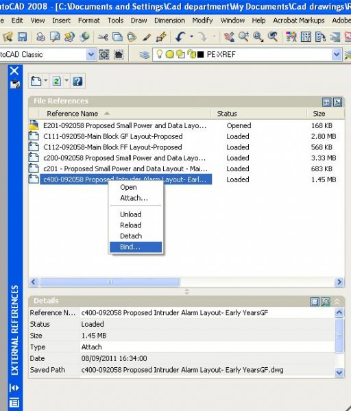

sparkyuk Posted October 25, 2011 Posted October 25, 2011 Well all I do is go to "Insert" (top left) select "External ref", once openned as my picture select the ex/ref right click select bind repeat for anyother ex/ref's job done, why it isnt showing up at all after you have done your binding i have no idea, I take it the ex/ref has already been inserted into your drawing yes ?. Please explain how you did your binding if different from above Quote

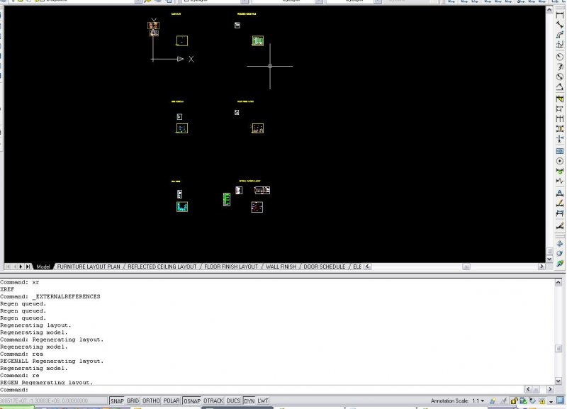

reinagrace Posted October 27, 2011 Author Posted October 27, 2011 here's the image after i bind the xref... and the other file is my working drawing. i'll see if i can attached the xref file. it's too big and i try to zip the file, it won't attached here... sample1a.dwgFetching info... Quote
reinagrace Posted October 27, 2011 Author Posted October 27, 2011 i really cannot attached the xref file. any suggestions?? i almost deleted all the contents of the drawing but still its 1.01MB( i tried purge/-purge, but still, get the same 1.01MB file)..... and i also tried binding again this time, (with almost all the contents deleted), still same results. Quote
RobDraw Posted October 27, 2011 Posted October 27, 2011 I think the problem may be in the XREF file. Try making a WBLOCK from that file with the stuff you can select and then xref the new file into you drawing. Quote

reinagrace Posted October 28, 2011 Author Posted October 28, 2011 @ rob, good job! i did just what u said, and viola! ahaha.... i have it binded.. what a relief.. thanks so much for the help. @ sparkyuk, i already sent the files, maybe you can find out what's wrong with the file i'm trying to xref.. normally, it should bind if there are no errors so at least, i can avoid the same errors in the future.. thanks so much for the help guys... Quote
