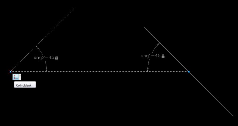

Hi,
I have to draw a rather weird drawing with a lot of angled lines. Currently I'm using UCS to draw them but it's really tiresome.
I would draw 1 line, then type in UCS, select the X and Y axis, draw that line, escape, then hit in UCS again, rinse and repeat.
Is there a simpler way? I tried polar tracking "relative to last segment" but it still uses the x axis as the base, which is not what I want. I want the line to be the X axis.

Since you are using 2010 you have the benefit of Geometric and Dimensional Constraints. This allows changing of angles without having to re-draw line segments... It can be quit handy.

You can draw line with using the geometric constraint. Draw your first line that you want to use for the relative angle measurement. From the second point you can draw a line with a specified length and then put the geometrical constraint on the both line as the first one to be selected firstly so that your second lines get rotated and gets oriented to the desired angle.

Another way of doing it is to copy a line upon itself, and then to rotate the duplicate line about an endpoint. :D
Yes the method Eldon is asserting is a good one.
You can try it also.
-CNatka
Actually you can copy and rotate at the same time - no need to make a duplicate before rotating.
