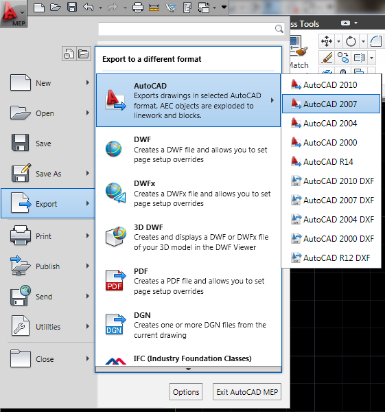

RobDraw Posted October 20, 2011 Posted October 20, 2011 If you are skipping a few versions when you are saving down, please use "export" instead of "save as". The saved down files and get screwed up if you use "save as". Quote

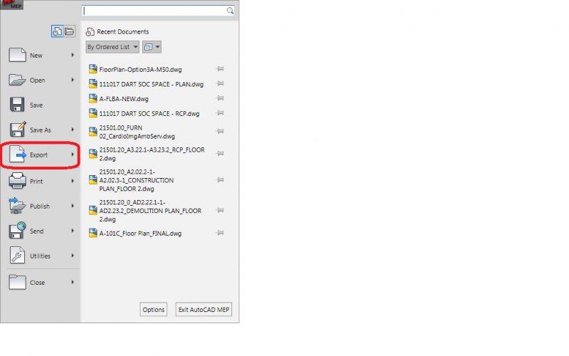

RobDraw Posted October 20, 2011 Posted October 20, 2011 I don't know what he's talking about but this is what I'm referring to. Quote

RobDraw Posted October 20, 2011 Posted October 20, 2011 DXF was already mentioned. I was simply saying that when saving down to earlier versions that the export command does a better job because simply doing a "save as" often causes issues. Quote

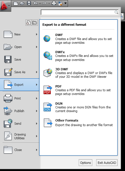

ReMark Posted October 20, 2011 Posted October 20, 2011 When I open that Export option that you have shown in your image I see options for DWF, DWFx, 3D DWF, PDF, DGN, FBX and Other Formats. If I click on Other Formats the Export Data window appears. In the drop-down list at the bottom there are several other file type options available such as BMP, SAT and WMF. DXF is not on the list (sorry if I may have given anyone the impression that it was) but there is an option to export as a Block in DWG format. Quote
RobDraw Posted October 20, 2011 Posted October 20, 2011 Those options are there but I was referring to the export to .dwg format. Quote
ReMark Posted October 20, 2011 Posted October 20, 2011 Strange. I don't seem to have that option at the top of my Export list (nor do I have the IFC option). What version AutoCAD was that image taken from? Quote
RobDraw Posted October 20, 2011 Posted October 20, 2011 That was taken from AutoCAD MEP 2011 but I can remember it being around for quite a while. Quote

f700es Posted October 20, 2011 Posted October 20, 2011 Only ACAD verticals (MEP, Arch, Civil) have the export feature Rob is showing. This is to allow the file to be used in vanilla cad and other dwg editors IIRC. My 2012 Acad is like what Remark says and my Arch 2012 is like your picture above. Quote
