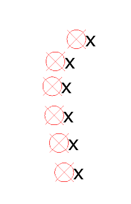

woodman78 Posted October 19, 2011 Author Posted October 19, 2011 I found this thread which gets me almost to where i want to go. http://www.cadtutor.net/forum/showthread.php?31653-Lisp-coordinates-of-points-to-excel-sheet-%28-point-number%29 This works fine if i place the points in with mtext because it detects the text and i can sort them in excel. Problem I have is how to number them in CAD. If I insert blocks like this that explode on insertion so that I am left with the red symbol which is a block and Mtext how do I transform the "x's" into numbers by choosing them. Can someone create a lisp that when I select the text it will become 1 and the next one I select will become 2 etc.? Sorry I;m all over the place on this but I'm under pressure with a lot of drawings to do so I'm looking for a solution. Quote
eldon Posted October 19, 2011 Posted October 19, 2011 I have a block and I'm using LeeMac's very cool NumInc3.1 to insert the block with an incremental number. I am wondering how I can list the X,Y for all the blocks of a certain name based on the ascending incremental number? Have you tried to use the AutoCAD Attribute Extraction? You have a block whose attribute is the number. The Attribute extraction will add on the insertion point coordinates to the number to give a very nice csv file Quote
Lee Mac Posted October 19, 2011 Posted October 19, 2011 This was fun to write, maybe it will help: (defun c:test ( / block def el en ent file in lst pt ss str tag tags val ) (while (not (or (eq "" (setq block (getstring t "\nBlock Name to Extract: "))) (and (setq def (tblsearch "BLOCK" block)) (= 2 (logand 2 (cdr (assoc 70 def)))) ) ) ) (princ "\nBlock not Attributed or not Found.") ) (if (not (eq "" block)) (if (setq ss (ssget "_X" (list (cons 0 "INSERT") (cons 2 block) (cons 66 1) (cons 410 (if (= 1 (getvar 'CVPORT)) (getvar 'CTAB) "Model")) ) ) ) (progn (setq ent (tblobjname "BLOCK" block)) (while (setq ent (entnext ent)) (if (eq "ATTDEF" (cdr (assoc 0 (entget ent)))) (setq tags (cons (strcase (cdr (assoc 2 (entget ent)))) tags)) ) ) (while (not (member (setq tag (strcase (cond ( (eq "" (setq tag (getstring (strcat "\nTag to Sort by <" (last tags) ">: ") ) ) ) (last tags) ) ( tag ) ) ) ) tags ) ) (princ "\nAttribute not found in Block.") ) (if (setq file (getfiled "Output File" "" "txt;csv" 1)) (progn (repeat (setq in (sslength ss)) (setq en (ssname ss (setq in (1- in))) pt (cdr (assoc 10 (entget en))) val nil ) (while (and (null val) (eq "ATTRIB" (cdr (assoc 0 (setq el (entget (setq en (entnext en)) ) ) ) ) ) ) (if (eq (strcase (cdr (assoc 2 el))) tag) (setq val (cdr (assoc 1 el))) ) ) (if val (setq lst (cons (cons val pt) lst)) ) ) (if (setq file (open file "w")) (progn (foreach line (vl-sort lst '(lambda ( a b ) (< (atof (car a)) (atof (car b))))) (setq str (car line)) (foreach x (cdr line) (setq str (strcat str "," (rtos x))) ) (write-line str file) ) (setq file (close file)) ) (princ "\nUnable to Open Chosen File.") ) ) (princ "\n*Cancel*") ) ) (princ "\nNo Blocks Found.") ) ) (princ) ) Quote
