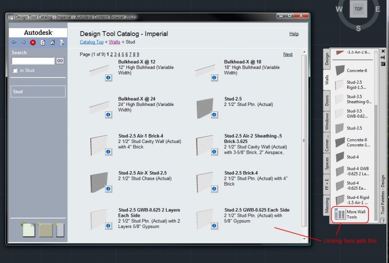

Here is what I mean...
then can you right-click on the style and change it after using it in your drawing, right?
