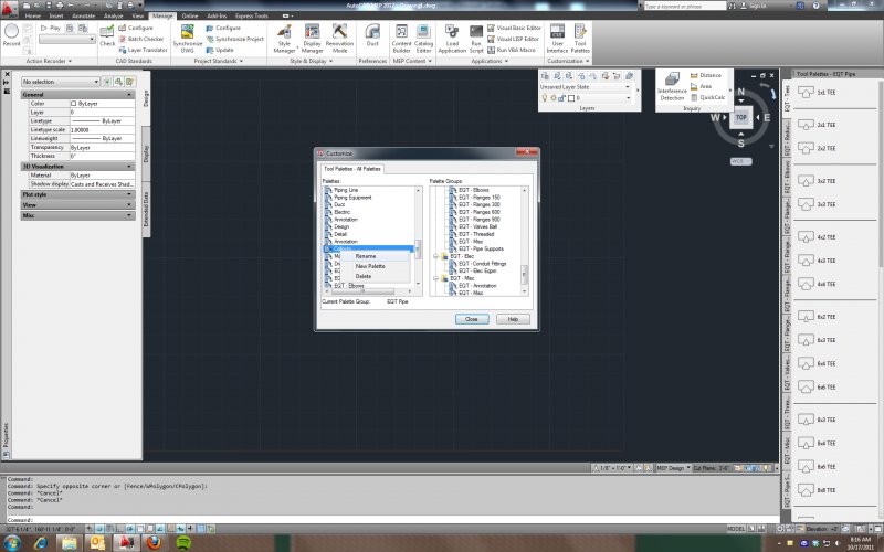

When I right click on the tool palettes, the only options available are "Rename", "New Palette", and "Delete".

Sorry, I should have been more specific. I have already followed the steps to get to the customization dialog window. When at the customization window, I right click on the tool palettes, and export is not an option. Screen shot attached.

I checked with the other designer using MEP 2012, he has the same issue. The Import and Export options are not available.
I check with a designer using MEP 2010. Same issue.
I also checked with a designer using Map 3D 2010. He does not have this issue. He has the option for Exporting.
Can anyone confirm that this is an MEP problem?
I don't believe it is a problem "per se". I believe this is intentional, on AutoDesk's part, primarily due to the use of something called the "Content Browser". Ring any bells? I believe there is a way around this however.
