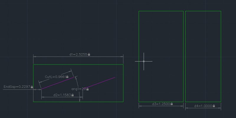

I am using dynamic blocks to automate the creation of 2.5d axis milling tool paths for a number of interrelated parts.
Reference this OVER simplified drawing:
The green are outside material cuts, magenta is inside tool paths for slots. Because this is being imported into a cam package, closed shapes have to be poly lines, draw order and line direction matter, etc.
overall height of finished product is sum(d1,d3,d4)
customer specifies (variables) overall D, d3, d4 and ang1 and d2. the slots are arrayed and d1 is lengthened as needed.
to achieve overall D while maintaining EndGap, d2,d3 and d4 are all adjusted as minimally as possible.
My orginal plan was just to develop a dynamic block BUT acad doesnt allow dynamic control of the array spacing AND as far as I can tell, dynamic blocks+boolean logic=FAIL
