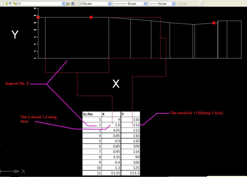

Want to draw graph as we do in graph sheet ! Help
hello frnds !
Can any body has idea to draw pline along X axis and Y axis. Actually i have two colume in excel spreadsheet. one colume contains value (that i want to draw along X axis) and other clumn has value that i want to draw along Y Axis. my pupose is simple make drawing as we do in Graph paper sheet. if anybody know any lisp programe or trick. Please share !!
Kindly find attached snapshot for more !
thnks

hey buddy ! Sound useful when i testing but it returns some error. kindly look into below command line. please suggest necessary remedies. i am using Au
Column ID: Header value:
1. - 1
2. - 0.4
3. - 32
Enter X column index:2
Enter Y column index:3
FX: bad argument type: VLA-OBJECT nil
Sorry about that, the code was primed for debugging. I've updated the code above which should get you on your way.
Can i have that Code. kindly Post here. Plz!
He edited his earlier post, the code is in that.
