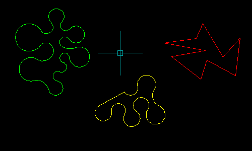

Gosh! I hope I haven't caused any marriage break ups with you guys spending so much time on this. :)
Don't laugh......Is there anything to be gained by somehow automatically breaking all arcs into multiple very small chords?
Indeed....
  Lee Mac said:
The arc segments can be included by using the curve functions to add the necessary additional points to the list of points for the MEC algorithm, as I have in my calling function.
I wish it could have been this easy:

Having spent some time studying a new algorithm, attached is my new version.
It hasn't failed (as yet) in my tests for any shape of LWPolyline, with or without arc segments.
A test function is included in the file, type 'test' to run the program.
Lee
MinimumEnclosingCircle.lspFetching info...
Lee Mac. You have truly nailed it.
I tried it on over 30 profile shapes. It's Perfect.
I can't thank you enough. Really made my day. I am genuinely exited to have this.
Thanks also to pBe and marko_ribar for worthy contributions.
I know I will use this constantly. I am wondering if now the problem is solved, whether it will be of use to anybody but me. I suspect not.
25 years of trial and error I have been doing this. hahahaha
Great Forum!!!!!!

BTW., I couldn't do entmakex to create LWPOLYLINE object, I tried what I could, and in the end I did it with (vl-cmdf "_.pline")... What I'm missing - this is unnecessary to answer if you don't want - it works and this way, but please answer on my first question about more dense segmentation if you can...
Thanks, M.R.
Great Forum!!!!!!
Excellent to hear Manila Wolf! I'm really glad that my code can save help you in your work - it was an interesting puzzle to solve and I have also learnt a greal deal from the challenge of solving it.
Cheers!
  pBe said:
Nice code Lee, i never even got past linear polylines :)
Thanks pBe :beer:
  marko_ribar said:
Lee, in your subfunction LM:LWPoly->List , what parameters can be changed to obtain more precise segmentation of arcs?
Hi Marko,
Change the '25' to a larger number:
(setq inc (/ (- di2 di1) (1+ (fix (* [color=red]25[/color] (/ (- di2 di1) rad (+ pi pi)))))))
Here is an example for you:

(defun c:circumpline ( / APP EN N OSM PT PTA1 PTA11 PTA2 PTA22 PTA3 PTL PTSE1E2ARCS TST X )
   (setq app (getvar 'aperture))
   (setq osm (getvar 'osmode))
   (setvar 'aperture 50)
   (setvar 'osmode 0)
   (while
       (progn (setvar 'ERRNO 0) (setq en (car (entsel "\nSelect LWPolyline: ")))
           (cond
               (   (= 7 (getvar 'ERRNO))
                   (princ "\nMissed, try again.")
               (   (eq 'ENAME (type en))
                   (if (not (eq "LWPOLYLINE" (cdr (assoc 0 (entget en)))))
                       (princ "\nInvalid Object Selected.")
   (initget 6)
   (alert "\nIf founded circle in current layer color is occasionally perfect \n(may give wrong results if helper circle doesn't intersect with picked pline using intersectwith function)\nYellow circle witch is erased during routine is helper circle that touches arcs but crosses them - it's Lee Mac result of LM:MinEncCircle")
   (setq n (getint "\nInput number for level of segmetation <360> - larger the number (slower), smaller the number (faster) : "))
   (if (null n) (setq n 360))
   (if
       (and en
           (setq lst
               (mapcar
                   (function (lambda ( x ) (trans x 0 en)))
                   (LM:LWPoly->List en n)
           (setq lst (LM:MinEncCircle lst))
       (setq ci
       (entmakex
           (list
               (cons 0 "CIRCLE")
               (cons 10 (car  lst))
               (cons 40 (cadr lst))
               (cons 62 2)
               (assoc 210 (entget en))
   (setq ptse1e2 (interse1e2 en ci))
   (setq plpts (mapcar '(lambda (x) (cdr x)) (vl-remove-if-not '(lambda (x) (= (car x) 10)) (entget en)) ))
   (foreach pt ptse1e2
       (mapcar '(lambda (x) (if (equal (list (car pt) (cadr pt)) x 1e-6) (progn (setq tst (cons T tst)) (setq ptl (cons pt ptl))  ))) plpts)
   (if (and (= (length tst) 2) (= (length ptse1e2) 4))
       (setq ptse1e2arcs (vl-remove (car ptl) ptse1e2))
       (setq ptse1e2arcs (vl-remove (cadr ptl) ptse1e2arcs))
       (entdel ci)
       (if (eq (vl-cmdf "_.circle" "3P" "_end" (car ptl) "_end" (cadr ptl) "_tan" (car ptse1e2arcs)) nil) (entmake ci))
   (if (and (= (length tst) 1) (= (length ptse1e2) 3))
       (entdel ci)
       (if (eq (vl-cmdf "_.circle" "2P" "_end" (car ptl) "_tan" (car ptse1e2arcs)) nil) (entmake ci))
   (if (and (= (length tst) 1) (= (length ptse1e2) 5))
       (setq pta1 (car ptse1e2arcs))
       (setq pta2 (FurthestFromPoint ptse1e2arcs pta1))
       (entdel ci)
       (if (eq (vl-cmdf "_.circle" "3P" "_end" (car ptl) "_tan" pta1 "_tan" pta2) nil) (entmake ci))
   (if (and (null tst) (= (length ptse1e2) 6))
       (setq ptse1e2arcs ptse1e2)
       (setq pta11 (NearestFromPoint ptse1e2arcs pta1))
       (setq ptse1e2arcs (vl-remove pta11 ptse1e2arcs))
       (setq pta2 (NearestFromPoint ptse1e2arcs pta1))
       (setq pta22 (NearestFromPoint ptse1e2arcs pta2))
       (setq ptse1e2arcs (vl-remove pta22 ptse1e2arcs))
       (setq pta3 (NearestFromPoint ptse1e2arcs pta2))
       (entdel ci)
       (if (eq (vl-cmdf "_.circle" "3P" "_tan" pta1 "_tan" pta2 "_tan" pta3) nil) (entmake ci))
   (if (and (null tst) (= (length ptse1e2) 4))
       (entdel ci)
       (if (eq (vl-cmdf "_.circle" "2P" "_tan" pta1 "_tan" pta2) nil) (entmake ci))
   (setvar 'aperture app)
   (setvar 'osmode osm)
Regards, M.R.
8)
Edited by marko_ribar
code revised
There was little my mistake... I apologize - code revised...
M.R.
Lee, if you want to help, you're always welcome... I think that code can be used to found correct solution (circle must touch arcs in single point)... I have difficulties to accomplish this as it now either gives solution or not at all. I don't know how to exclude (vl-cmdf "_.circle" ... "_tan" pt ...) if it doesn't create perfect solution, and leave your circle now in yellow color... The code is almost perfect, but still I don't quite know how to finish it to be perfect...
M.R.
