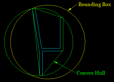

Just wondering if anybody knows of a lisp that will draw a circumscribing circle around an irregular shaped closed polyline or region. The circle to be the smallest diameter that the shape will fit inside of.
Something like the attached drawing.
I can draw by trial and error using the circle command (2 points or 3 points), but it would be nice to automate this. I am quite lazy! :)
The reason I am looking for this, is because with the design of dies for aluminium extrusions, a common measurement for evaluating tolerances of extrusions and a check on the extruders capacity to create an extrusion, is the circumscribing circle diameter (CCD) of a profile.

I think its quite easy
vla-get-boundingbox is all you need
Hi pBe, thanks for the response.
Firstly, let me state that I am not au fait with lisp programming.
I am being cheeky, asking if anybody can help and point me to something that I can copy. :)
Does bounding box give the extremes of a rectangle only? If it does it will not work in all cases. I think it would work for the sample drawing I attached, but not for all shapes.

For reference, the now attached drawing would be the desired result for the previous attachment.

It would also depend upon whether you require the part to be centralised within the circumscribing circle; the bounding box method will centralise the object, but a smaller circle can be obtained for some parts if the part is located off centre.
For the off-centre circle, you could find the convex hull of the points that make up the polyline object, then construct a circumscribed circle from this convex polygon; or simply follow the algorithms for the famous smallest circle problem.

This code uses a variation of the algorithm used by Highflyingbird here:

Neither your, nor mine code works on plines with arcs, or plines-polygons... :(
At least, to make myself satisfied, my code don't take in consideration these examples and doesn't give any result, but your code is calculating and eventually never completes calculations - you have to terminate CAD...
Updated my code with Lee Mac info...
M.R.
Edited by marko_ribar
Sometimes mine works, sometimes it doesn't - I may have to reconsider the algorithm. :(
marko_ribar and Lee Mac,
Sincere thanks for your contributions.
I see those pesky arcs and fillet radii are causing the headaches!
To confirm: - The shape does not have to be centralised. The target is indeed the smallest diameter possible even if the profile is off centre.
I've changed my code finally - it includes n-polygons and plines based on them... Still, I can't do it with my knowledge to include arcs in considerations - POLYLINE must have STRAIGHT SEGMENTS, and must lay on elevation 0.0

 (setq ci (entlast))
 (foreach pt (interse1e2 pl ci)
   (mapcar '(lambda (x) (if (equal (list (car pt) (cadr pt)) x 1e-6) (setq tst (cons T tst))  )) plpts)
 (if (and (/= (length tst) (length (interse1e2 pl ci))) (/= (length (interse1e2 pl ci)) 2))
   (entdel ci)
   (setq ii -1)
   (setq ssci (ssadd))
   (repeat (length plptsrest)
     (setq ii (1+ ii))
     (vl-cmdf "_.circle" "3p" (nth nn plpts) (nth mm plpts) (nth ii plptsrest))
     (setq ci (entlast))
     (if (/= (length (interse1e2 pl ci)) 3) (entdel ci) (ssadd ci ssci))
 (if (not (vl-catch-all-error-p (vl-catch-all-apply 'sslength (list ssci))))
     (if (> (sslength ssci) 1)
       (setq ssn -1)
       (repeat (sslength ssci)
         (setq ssn (1+ ssn))
         (setq ci (ssname ssci ssn))
         (vl-cmdf "_.area" "o" ci "")
         (setq aa (getvar 'area))
         (setq aalst (cons aa aalst))
       (setq aalst (reverse aalst))
       (setq aamin (eval (cons 'min aalst)))
       (setq ssn -1)
         (setq ssn (1+ ssn))
         (if (= aamin (nth ssn aalst)) (setq ci (ssname ssci ssn)))
       (setq sscirest (ssdel ci ssci))
       (vl-cmdf "_.erase" sscirest "")
M.R. :)
Thought about creating points based on "smallest circle problem" link posted by Lee or similar algorithm , but problem i see with that as you guys probably know and noticed by now are arc segments.
I'll keep digging :)
If you can construct a bullet-proof algorithm for calculating the 'Minimum Enclosing Circle' (MEC) (various methods: use of Convex hull / Megiddo's Algorithm etc.), for any set of points, then you are done.
The arc segments can be included by using the curve functions to add the necessary additional points to the list of points for the MEC algorithm, as I have in my calling function.
The difficult part is writing a concrete algorithm for any point set.
Edited by Lee Mac
