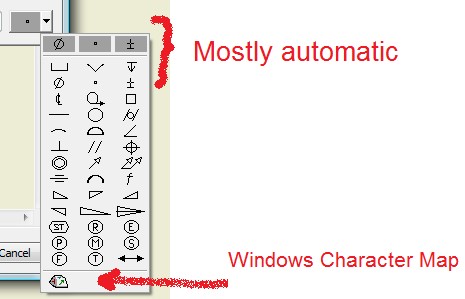

JD Mather Posted October 14, 2011 Posted October 14, 2011 Jack_O said: I haven't seen anybody use those symbols in years and years. If I were to call that out on something' date=' I'd use a leader with this note: DR. 0.070 DIA (#50)~0.200 DP. TAP 2-56 UNC -3B~0.172 DP. [/quote'] The symbols are current ANSI standard - words (or abbreviations of words are out). Modern MCAD (Mechanical CAD) programs like Autodesk Inventor automatically add the symbols to things like counterbore, countersink and thread notes when dimensioning. I'll try to post some screen shots when I get a chance. Quote
Jack_O'neill Posted October 14, 2011 Posted October 14, 2011 JD Mather said: The symbols are current ANSI standard - words (or abbreviations of words are out).Modern MCAD (Mechanical CAD) programs like Autodesk Inventor automatically add the symbols to things like counterbore, countersink and thread notes when dimensioning. I'll try to post some screen shots when I get a chance. Oh I believe you. All of my current customers have their own standards that they've used forever and what I used as an example is how most of them have such call outs specified. One of them even says that "the use of cryptic symbols other than those defined on the leadsheet should be avoided". They've only been in business for a little over a century, and seem to think their way works for them. Of course, they are the customer I've made mention of in the past of having to save down to 2004 format. As long as they keep writing good checks, I will call it out in pig latin if thats what they want. Quote
JD Mather Posted October 14, 2011 Posted October 14, 2011 Quote ...the use of cryptic symbols... The concept is that the symbols can be (?) understood across languages whereas words (or abreviations) like C'bore, C'sink, DP, TYP (TYPICAL) are not language neutral. But hey, here in the US we still use mostly imperial rather than metric. If only Jimmy Carter had mandated that speed limit signs were ONLY metric rather than dual dimension (MPH/KPH) we would have had a world standard long ago. It is the conversion (translation) between starndards that causes problem. Didn't take long to get a feel for 2Liter. The symbols in the first two rows are mostly added automatically as the software knows a counter bored hole is a counter bored hole, but of course manual editing can be used as needed. For symbols not in the common GDT list there is a link to the Windows Character Map for quick access. I might also add that in the modern MCADs (like SolidWorks) they are units aware - that is if units mm is added to magnitude the software knows that - can enter mixed unit equations like 10in + 30mm or whatever appropriate units added the magnatude and the geometry reflects the desired units entry. Make fitting things like metric motors to old inch equipment much less error prone as conversions not needed - the software takes care of units. Quote
