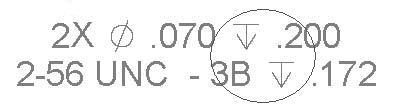

Tankman Posted October 13, 2011 Share Posted October 13, 2011 Been drafting plumbing layouts, years. Now, trying a few mechanical *.dwg drawings. Does anyone have a source for "free" drafting symbol blocks? Looked, fruitless search. Guess I could make 'em as I go, as required but, would be so nice to download a bunch to get out-of-the-gate runnin'. TANKS! Quote Link to comment Share on other sites More sharing options...

Tankman Posted October 13, 2011 Author Share Posted October 13, 2011 Can you name a couple of representative symbols that you are looking for? How deep the bore is, horiz line with vert line down & arrow, parallel, machining "stuff." Used the symbols on the board but, not in AutoCAD. Guess I could build a library if this work is on-going. Quote Link to comment Share on other sites More sharing options...
ReMark Posted October 13, 2011 Share Posted October 13, 2011 Aren't some of those symbols part of a font? I vaguely recall a thread that touched upon that very subject. Quote Link to comment Share on other sites More sharing options...
Tankman Posted October 13, 2011 Author Share Posted October 13, 2011 Aren't some of those symbols part of a font? I vaguely recall a thread that touched upon that very subject. I was thinking "alt key combinations", didn't look too far but, didn't see any. Yet. Quote Link to comment Share on other sites More sharing options...
ReMark Posted October 13, 2011 Share Posted October 13, 2011 So we're talking about: countersink, depth, bore, radius, spotface and diameter for example. Right? OK...had another cup of coffee so the old noodle is synapsing away like a locomotive. I believe the font you are looking for is GDT.SHX. Take a look. Quote Link to comment Share on other sites More sharing options...

Tankman Posted October 13, 2011 Author Share Posted October 13, 2011 (edited) Have you checked out that font yet? Will check the font (gdt.shx) when I returned to Eastern PA, tonight or tomorrow. Visiting a job site in Harrisburg at the time, lousy weather, unlike the past few days. Oh well, ya get what you get. **Interesting font but, no cigar. One drafting symbol means "deep", like a T and small v, looks like this.** Edited October 14, 2011 by Tankman Quote Link to comment Share on other sites More sharing options...

Jack_O'neill Posted October 14, 2011 Share Posted October 14, 2011 Will check the font (gdt.shx) when I returned to Eastern PA, tonight or tomorrow. Visiting a job site in Harrisburg at the time, lousy weather, unlike the past few days. Oh well, ya get what you get. **Interesting font but, no cigar. One drafting symbol means "deep", like a T and small v, looks like this.** [ATTACH=CONFIG]30555[/ATTACH] I haven't seen anybody use those symbols in years and years. If I were to call that out on something, I'd use a leader with this note: DR. 0.070 DIA (#50)~0.200 DP. TAP 2-56 UNC -3B~0.172 DP. Keep in mind, you might be able to measure the drill depth to 3 decimal places, but its gonna be next to impossible to control the tapped depth that accurately. What in the world are you putting those little tiny screws in anyway? I always hated working with those. Quote Link to comment Share on other sites More sharing options...
rkent Posted October 14, 2011 Share Posted October 14, 2011 I haven't seen anybody use those symbols in years and years. If I were to call that out on something' date=' I'd use a leader with this note: DR. 0.070 DIA (#50)~0.200 DP. TAP 2-56 UNC -3B~0.172 DP. Keep in mind, you might be able to measure the drill depth to 3 decimal places, but its gonna be next to impossible to control the tapped depth that accurately. What in the world are you putting those little tiny screws in anyway? I always hated working with those.[/quote'] ASME still uses those symbols, I would use those rather than the notes. And if using ASME GD&T that is the only option. Quote Link to comment Share on other sites More sharing options...
