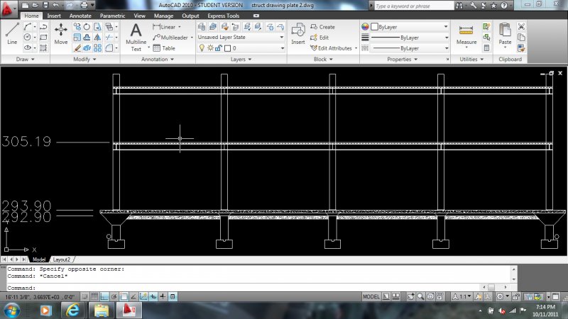

Awesome thank you very much. Ok now that i have accomplished that monumental task lol. Will someone please glance at my drawing and tell me if it looks alright so far. This is the south elevation of the structural drafting section of penn foster. Two of the things that i have not done yet is put in the sliding door and slant the roof for the drain. well and add the drain. oh crap and add the rebar in the footings. lol. I have drew it all on layer 0.

Where is your rebar? Shouldn't the beam cross-sections also show the angle clips on either side?
Thank you ReMark. I also have a question on the roof. It is supposed to have a slight slant 1/8" every 1' to a drain that is between row 2 and 3. Do I find where the drain is and draw the slant to the walls using the 1/8" increase till I reach the walls?
Do you know the location and elevation of the drain?
Do you already have your wall heights set?

Yes, I have the wall heights but for the drain the directions says it is similer to the one shown in the second part of Figure 21-56 in the work book. But, when you look at the one in the work book it does not give any size discriptions on the inlet drain or anything.

It looks like you might be on Plate 3. Is that correct?
The roof slab is 6" high at both ends. It is roughly 4-1/8" high at the center of the roof drain. It is 27'-0" from the centerline of the far left hand column to the centerline of the drain. The drain size should be called out in the mechanical details.

Actually, I am working on plate 2. But, the roof should still slope right? I guess I would be talking about the slope North and South. The opposite of the one on plate 3. Please let me know if I am wrong! Thank you.
I would have to take a look at the instructions. It may well be pitched towards the drain in both the north-south and east-west directions.

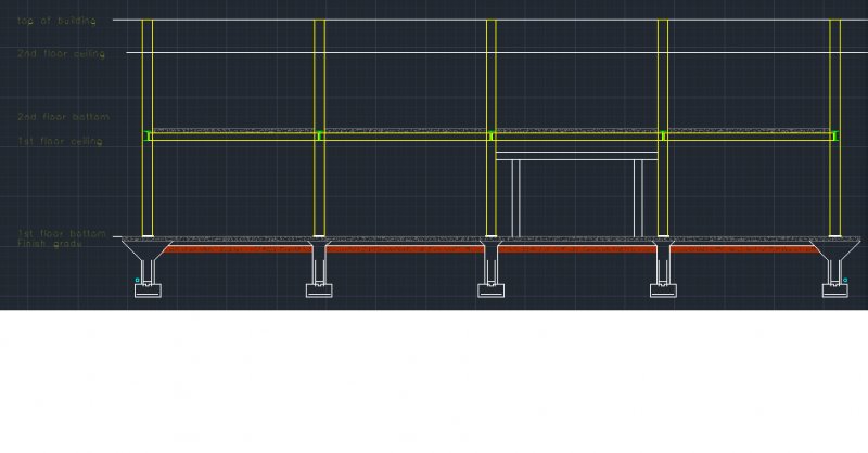

Hi,
Can someone please tell me if I am on the right track, if and what I have done incorrectly?
Any help would be greatly appreciated!!!
