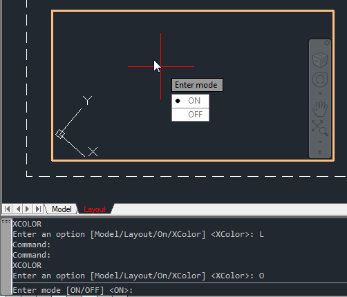

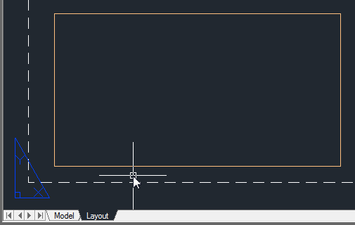

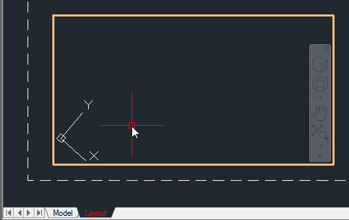

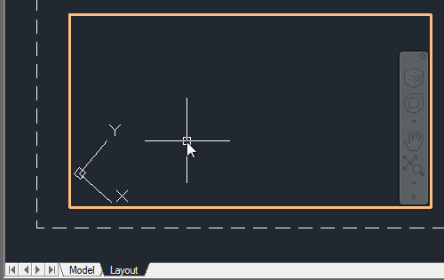

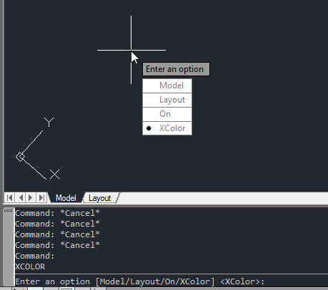

BlackBox Posted June 24, 2013 Share Posted June 24, 2013 (edited) [backOnTopic] I actually find that adding a layer of 'visual feedback' is quite useful during production. At the risk of spoiling an upcoming project release .... I coded a small application a couple of years ago, which allows me to select a color for each Model, Paper, and PViewport Active... What this does for me, is allow me to visually determine what space I am in, based on the color of my crosshairs (without the need to glance elsewhere on the screen to determine same). I call this application XCOLOR... And am in the process of porting my Visual LISP code to .NET for both expediency (there's a +/-0.25 sec lag manipulating the COM PreferencesDisplay each time I change space; only noticeable on really slow machines, but still), and to make it more portable to others via Autodesk Exchange. My XCOLOR Command, allows me to change the setting for each space's crosshair color, regardless of what space I am currently in: ... Meaning I can be in Model, and change the PViewport Active color, the next time I go there (PViewport Active), the color is programmatically changed accordingly: I also built-in the ability to turn off this functionality mid-session, which would restore the user's original default COM DisplayPreferences setting: The user's original default color is stored up front, and restored at session close, just in case the application is not loaded next time, etc.. This application accounts for both different tabs within the same drawing, as well as any drawing opened in the Editor at the time the user switches. Edited June 24, 2013 by BlackBox DisplayPreferences should have been PreferencesDisplay, link added. Quote Link to comment Share on other sites More sharing options...

Currahee Posted June 24, 2013 Share Posted June 24, 2013 I actually find that adding a layer of 'visual feedback' is quite useful during production. At the risk of spoiling an upcoming project release .... I coded a small application a couple of years ago, which allows me to select a color for each Model, Paper, and PViewport Active... What this does for me, is allow me to visually determine what space I am in, based on the color of my crosshairs (without the need to glance elsewhere on the screen to determine same). I call this application XCOLOR... And am in the process of porting my Visual LISP code to .NET for both expediency (there's a +/-0.25 sec lag manipulating the COM DisplayPreferences each time I change space), and to make it more portable to others via Autodesk Exchange. My XCOLOR Command, allows me to change the setting for each space's color, regardless of what space I am currently in: [ATTACH=CONFIG]42600[/ATTACH] ... Meaning I can be in Model, and change the PViewport Active color, the next time I go there (PViewport Active), the color is programmatically changed accordingly: [ATTACH=CONFIG]42601[/ATTACH] [ATTACH=CONFIG]42602[/ATTACH] I also built-in the ability to turn off this functionality mid-session, which would restore the user's original default COM DisplayPreferences setting: [ATTACH=CONFIG]42603[/ATTACH] [ATTACH=CONFIG]42604[/ATTACH] The user's original default color is stored up front, and restored at session close, just in case the application is not loaded next time, etc.. This application accounts for both different tabs within the same drawing, as well as any drawing opened in the Editor at the time the user switches. Thats old technology Quote Link to comment Share on other sites More sharing options...
BlackBox Posted June 24, 2013 Share Posted June 24, 2013 I actually find that adding a layer of 'visual feedback' is quite useful during production. Ohh! Forgot to mention, that this custom 'visual feedback' can be applied to any aspect of AutoCAD that the user can colorize... Background color, etc., say you wanted your crosshairs to remain static. Cheers Quote Link to comment Share on other sites More sharing options...
