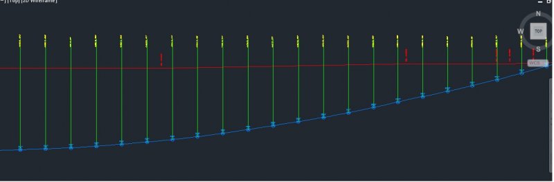

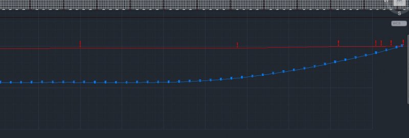

francois28 Posted October 9, 2011 Posted October 9, 2011 I am working on a horizontal directional drill with multiple survey points. The survey points make up (what looks like an upside down dome) and they are all connected with polylines. I need to add straight vertical lines to each point. Of course I can do this manually, but I'm wondering if there's a way to automate it. I've tried Lee's point manager, but it seems the problem is there's no option for xstart, xend, and ystart, yend. I also tried created a block out of a line then importing that on the points with point manager, but I need all of the lines to end at the same position at the top. This doesnt work because as you can see the points aren't all equal from the bottom. I also cannot find a way to trim blocks. I was hoping blocks would have the same xstart and xend, etc. as a line, but they don't. Any help would be appreciated, it seems like there should be some sort of easy way to do this. Quote

francois28 Posted October 9, 2011 Author Posted October 9, 2011 I don't think it will work with blocks.Have you verified how extrim works without blocks? How many points are you talking about? How often do you need to do this? If a one-off and not too many points I would set my osnap to Node - create one line and then copy at the other nodes, then extrim. Is there any sort of pattern - say regular x interval? I have verified how extrim works, and it's great with regular lines. If I could get the lines imported this way, there would be no problem at all. We're talking hundreds of points per drawing. And this will need to be done very often, every drawing that I do. Unfortunately there is no real pattern. The survey shots (each point) are taken at the end of each joint of pipe, which varies in length from retooling, damage, etc. The depth also fluctuates obviously because of drilling. I attached two images to show what I'm trying to do. One shows without the vertical (green lines) and the other that I input manually. Quote
