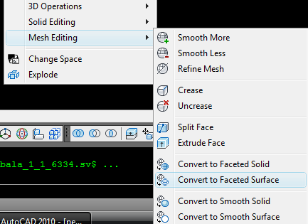

kencaz Posted October 9, 2011 Posted October 9, 2011 convert what into a surface? Clive Your Mesh of course: Quote

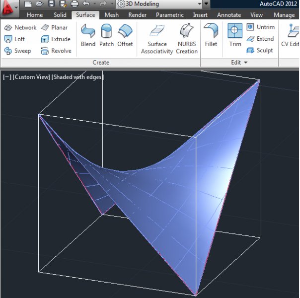

SEANT Posted October 15, 2011 Posted October 15, 2011 For something like this I’d recommend using the Loft methodology – though I think 2 lines is enough (see attached). Patch is useful; though in this instance the resultant geometry is a trimmed surface. AutoCAD does not treat it as such, but the isolines suggest it – the Acis/Brep information confirms it. So, even if the surface is within tolerance, the Patch will not have traits associated with the doubly ruled hyperbolic paraboloid, nor a regular (fully contained) UV Parametrization. LoftVsPatch.dwg Quote
