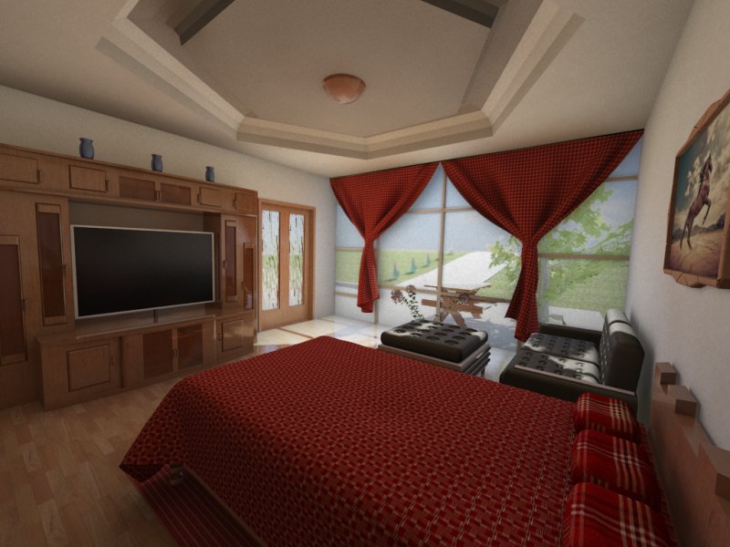

With the software i utilized a render from a few months back created with the comments and creative criticism of Rod Deweese. Link to Rod's portfolio http://www.rdeweese.com/
Image created by Raudel Solis
shown above.. and with the plugin i received an amazing image resized to a width of 5500px and the height i do not remember but it was proportional to 5500. the image looked great.
