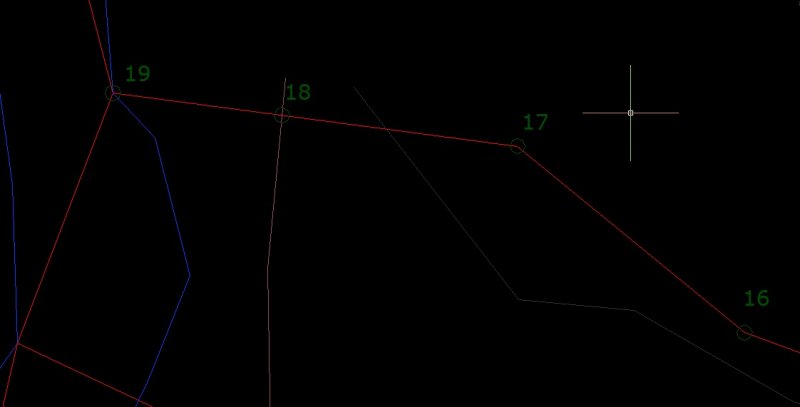

i have drawings that have as point a circle and near of the circle is numbered text eg 18 .
Those circle is stake out points i want if it possible to export those to text file like the first you post but with the numbers near of the circle.
eg text file
point nubmer, x,y
18,5124.24,45646.63
19,5454.26,46566.63
look the image of attachments..
thanks
