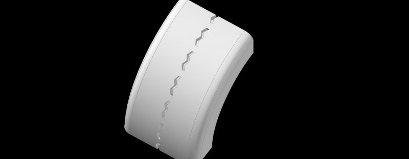

ReMark Posted October 11, 2011 Posted October 11, 2011 I don't have much time but I did manage to throw this together. The procedure relies on creating a profile, extruding it down into the tire, then using the Array command. I worked with a quadrant. I then used the Subtract command to achieve the results you see here. There are probably better ways to do it but I don't have the time to pursue them at the moment. I'll leave that task to one of the smarter forum members then we'll both learn something new. Quote

ReMark Posted October 12, 2011 Posted October 12, 2011 Quadrant = one quarter of the tire. Easier to work with. I used as my reference a point equal to the midline of the tire's profile. Quote
